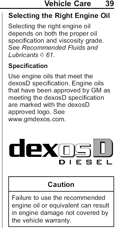

You MUST use DexosD appr
oved oils.
This is not true, all the oil has to do it meet the spec's.  Anyone who says you have to use dexosD approved oils is fear-mongering.
From the owners manual, note the words "or equivalent"
