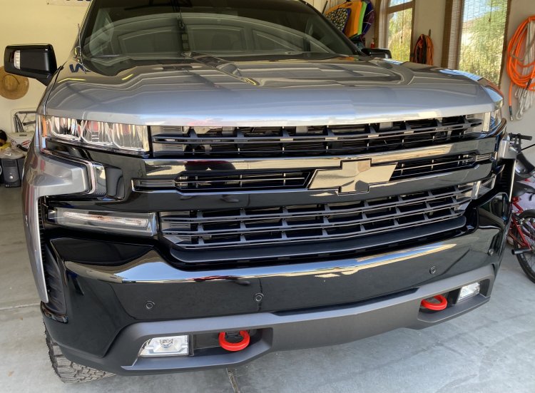

I really appreciated your feedback on my RST.  I'm going to leave the grille and bumpers the same color (satin steel metallic).  But all the badging is going black and I'm putting the rally stripes on hood and tailgate.
With that in mind I want to get rid of the chrome on the bow tie.
As a last resort I will plasti dip the bow tie on my 20, don't worry, I plan on using a trim removal tool....put painters tape on the grille under where im prying and pop it off.   Should come off without a hitch.
BUT.....
1.  Anyone know if Chevy makes an all black bow tie for the 2020 grille like this one???  (No chrome)
2.  Does a bow tie from a 2019 fit a 2020?  I know there were some front trim changes.
Its either this or my last resort....plasti-dip.

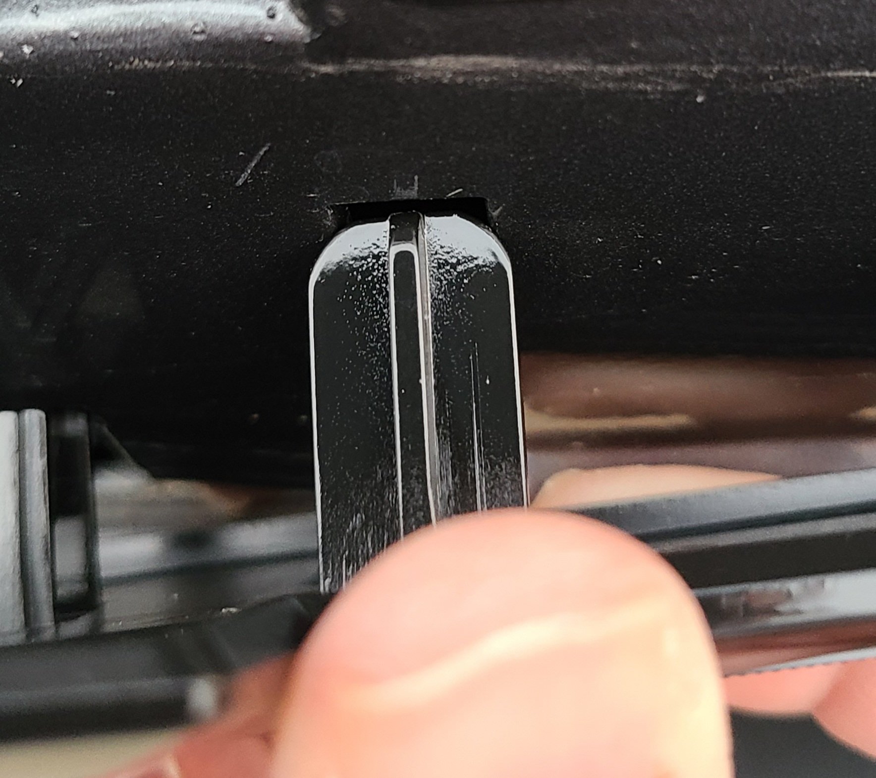

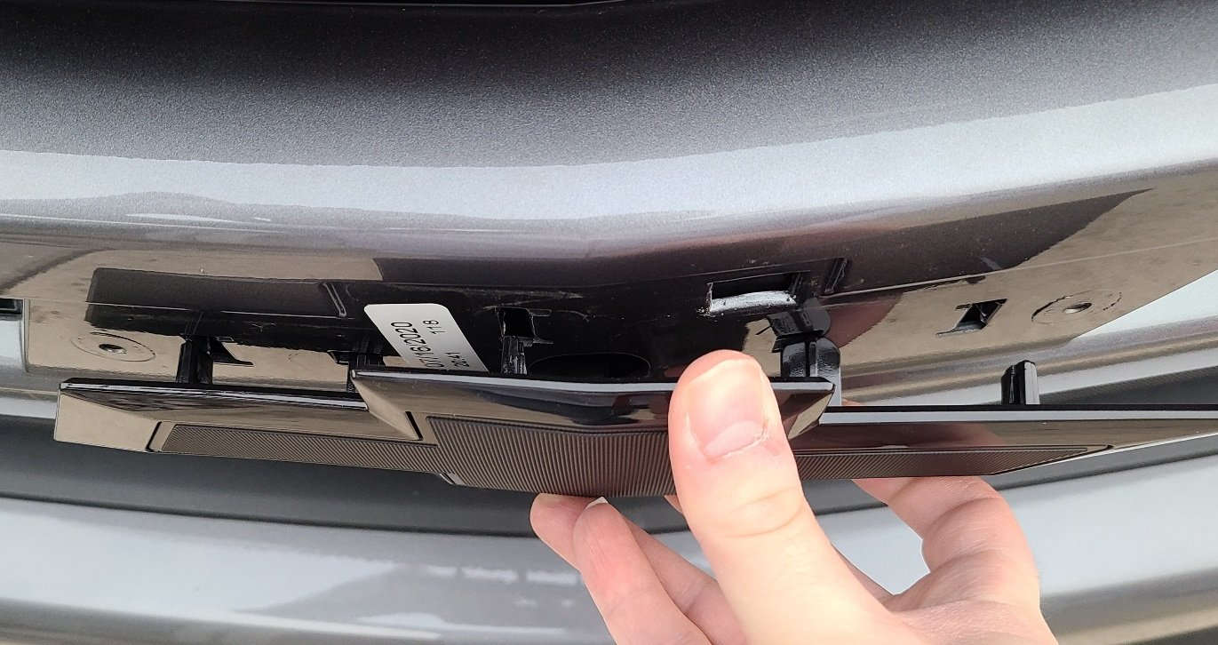

Thought I'd share this here too in case anyone does a search.. ..
2018 and down bow ties do not fit the 2019 and 2020 Silverado's.
Its slightly smaller....and the tabs do not line up from end to end and one of the tabs is too wide to fit a placement hole.  It could be shaved down, but again, from end to end the tabs (clips) do not match.  The bow tie itself is about 1/4" shorter from side to side and top to bottom.  And the two outside tabs are about 1/2" longer than the receiving holes on the grille.
Also...the chrome bow tie from the 2019 and 2020 is exactly 4" high and 12" wide ....right on the dot.   BUT, I can report how easy this one comes off with trim tools.  Just work from one end carefully....I had it off in 20 seconds.
So until Chevey comes out with an all black one, or an aftermarket one comes out, we are stuck to plasti-dip.
