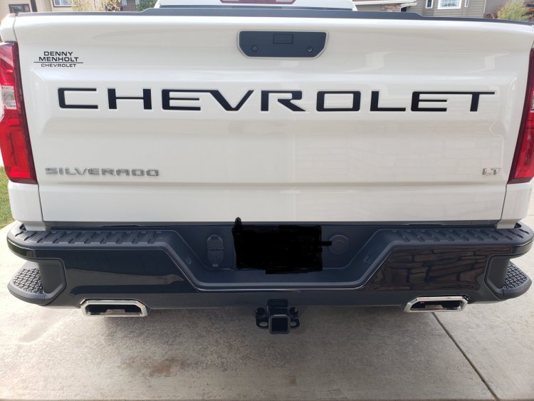

Almost forgot to post the "done" pics here.
Installed the badges over the weekend... very happy with the end result. After having these on for a few days now, I really like them over the original chrome ones. Adhesive seemed quality at time of install. Only time will tell on how it holds up.
As many said the factory adhesive is tough. Just keep heating it with a hair dryer (not a heat gun) and peel it back over itself into a ball. Then the Goof Off takes minimal effort to remove the rest. I prefer the Goof Off over the Goo Gone when debadging. I've never had the acetone damage the paint and it seems way more effective then the citrus based Goo Gone IMHO.
