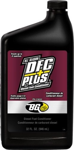

BG DFC Plus here. 4oz per 100L. We use it in our bulk tanks. Also use their other products in our fuel system cleaner tool.
Ive heard Hotshots is good stuff. Seeing is believing, and the ball bearing test is the true test. Ive seen what I thought were great products, do absolutely nothing. BG, stanadyne and hotshots all passed the test.
BUT you can overdose with these. We have seen too much conditioner cause a jelly in the tank and filters. As mentioned in above post, a little goes a long ways.
