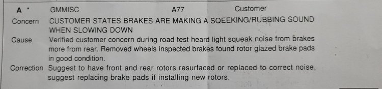

Where's the copy of the TSB? I'm sure plenty of us here could use that info.
On 12/14/2020 at 3:12 PM, dab5577 said:
https://www.tsbsearch.com/Chevrolet/20-NA-020
