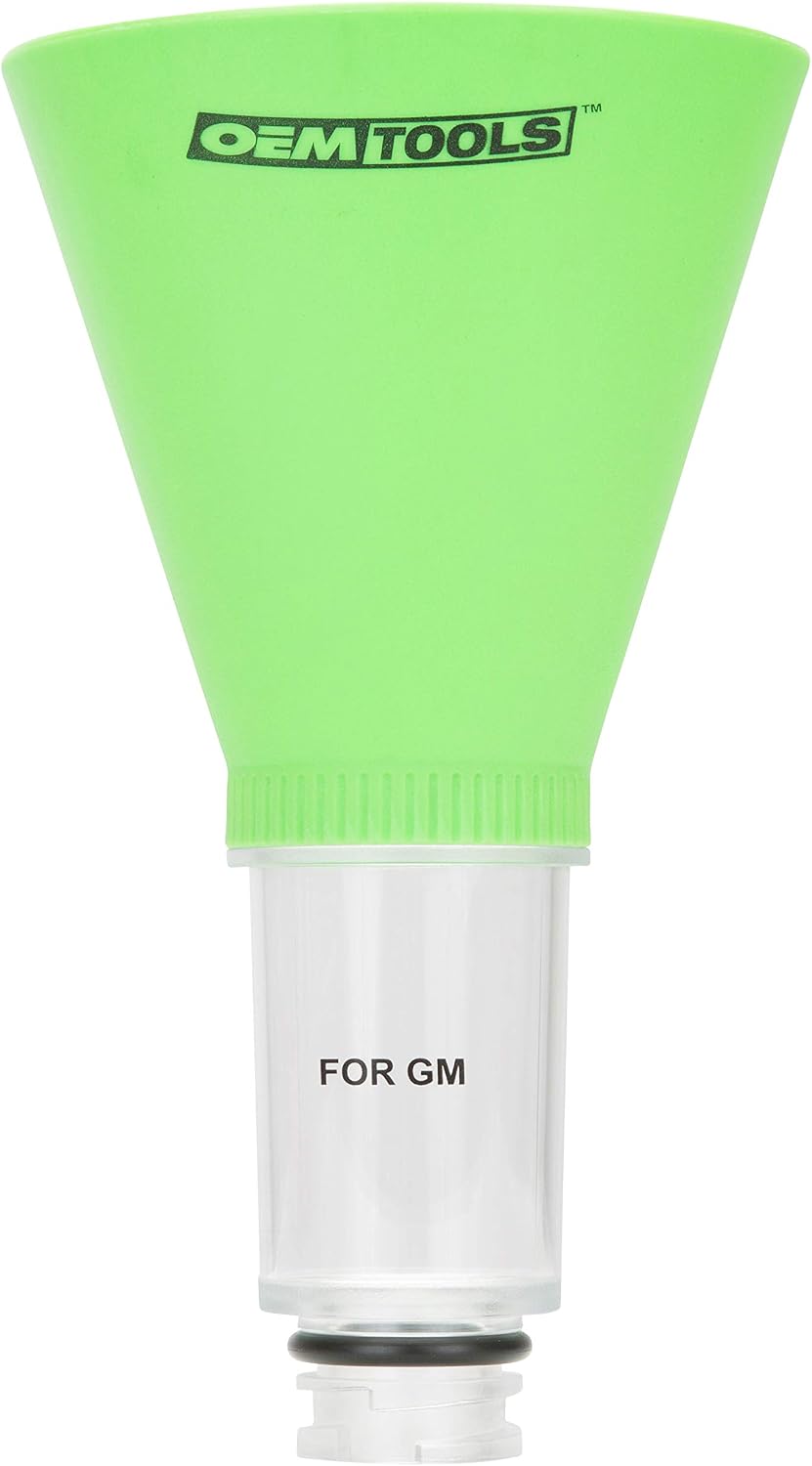

Did my second oil change on the truck last night and first one I did myself. 11,760 miles and 10% OLM after having it changed at 5,000 miles at the dealer for the 1st free oil change and service. Underneath the truck it was nice and wide open and the oil plug points down better than my last Silverado. 15 mm socket for the oil drain plug. Oil filter was also easy to change with my 3 prong oil filter wrench. Reaching into the engine bay was a stretch to hold my funnel and pour in the oil. I need a different funnel and it will be easier. 8 quarts of Mobil1 full synthetic Dexos 5W-30 and AC Delco PF63E oil filter.

I bought a cheap funnel already to cut and mold an angled neck on it, but will get that special one if I can't make mine work.
