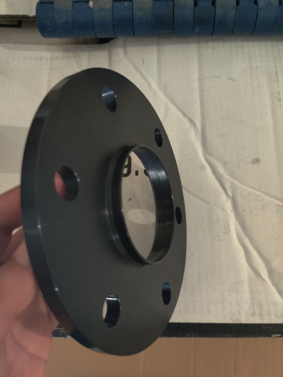

Anything over 3mm you won't be hub centric anymore unless you get a spacer with new studs. 10mm spacer can't be used with stock studs. What wheel are you trying to fit?
This is incorrect. I personally have some 10mm spacers from BORA and they have the lip for the wheel to sit on. Also you can buy extended thread lugs that will allow you to use the stock  wheel studs.
Just using a 10mm spacer (without lip) won't be hub centric and will be lug centric. Post a pic of your spacer. Your using stock studs with a 10mm spacer? Once you post I'll explain why.
As requested. You can see the extended thread lugs take up what's lost from using the spacer. The extended thread goes into the lug wheel pocket so you don't loose any thread engagement.
