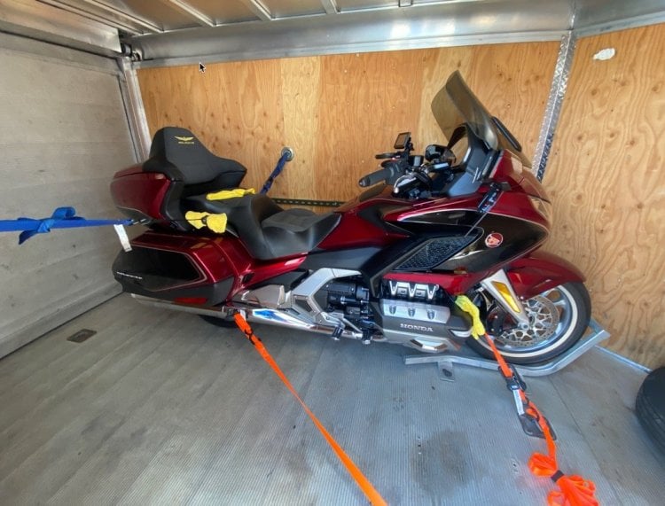

Currently pulling a rental V-nose trailer hauling my 2019 Honda Goldwing for about 1500 miles (see below).
This trailer requires almost the full 7" drop to sit level.
