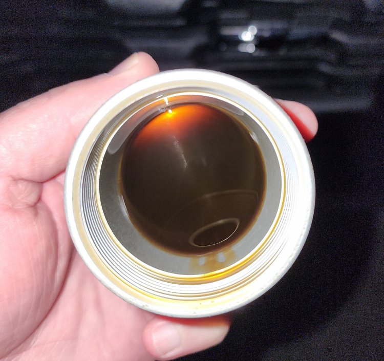

25 minutes ago, mrjulian416 said:
That's a ton... oil/water or mostly oil, mostly water?
Its oil. Super thin oil but oil nonetheless.  That's pretty on par with my 5.3. So to me GM's oil separator didn't change anything. Makes me glad I installed one now though.

On 1/12/2021 at 1:16 PM, djxn40 said:
This is after 300 miles or so of highway driving. So imagine pulling
Wow! That’s more than I thought there would be.
