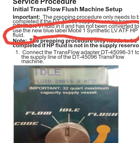

What's the difference between the flush process outlined in the TSB vs a regular transmission flush  the dealer would perform for routine maintenance?  I'm just over 30k miles and thinking it may be good time to just do a flush but this actually solve anything or is there a specials procedure that needs done?
It's a regular flush/fill but they need to use the more expensive synthetic HP Trans fluid.  We brought ours in 2 days ago and they were going to replace it with the same factory fluid.  Using this fluid (photo) eliminated our shudder.
