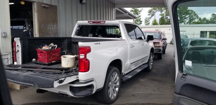

The dealership has a body shop doing the repair and they are waiting on the new window. The dealership said gm has a new part number window that just came out. The window should be in and installed today and I will pick  it up Monday afternoon. Here is a picture of the truck. They didn't take the rear window spoiler off. The dealership also said they were going to ask GM to cover it under warranty. I have already called GM customer service and I have a case number for this.
