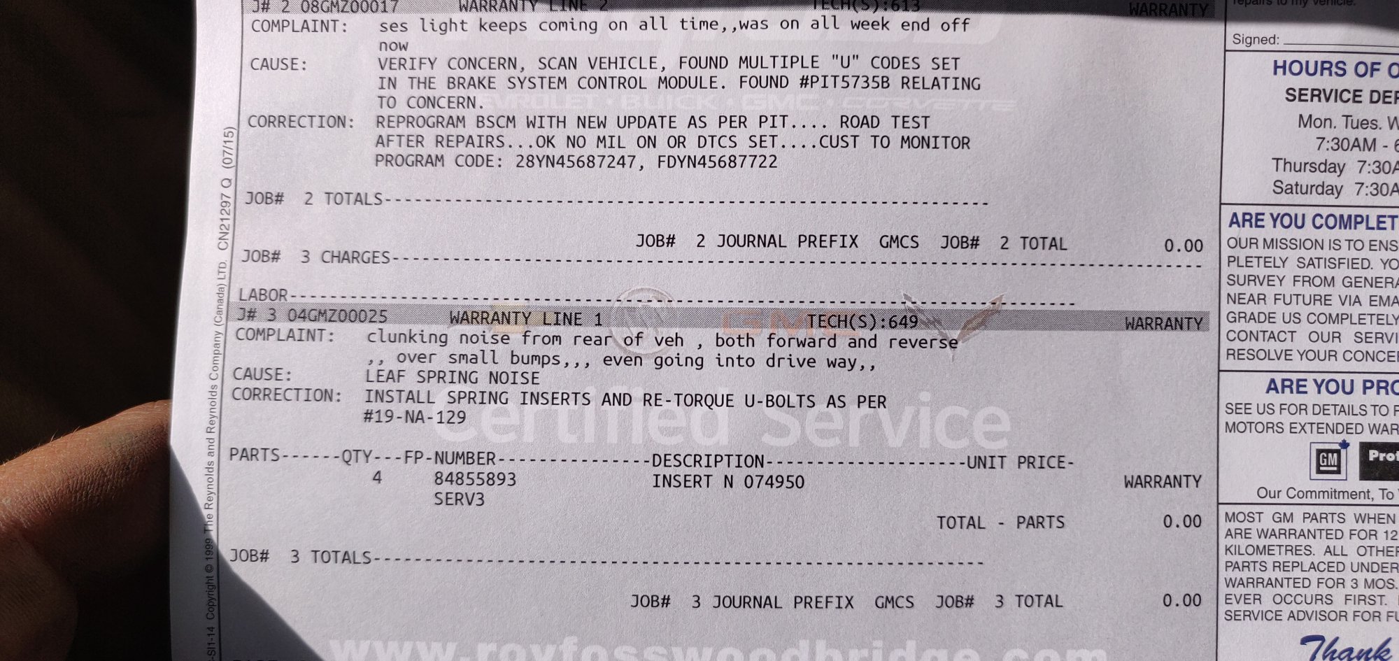

Will find out on Thursday!  I have an appointment to have two TSBs fixed at the dealer.
2 hours ago, tinbad said:
Sorry I couldn’t find the paper they gave me with the part number, but here’s the TSB they used to fix the creak with a leaf spring “insert”. Whatever that means.
Thanks for posting this tinbad! This is exactly the TSB lapoolboy linked. Sounds like that is the issue... Wonder if this ends up being an every 10k miles part...
Man it's a $2 part (84730971), im tempted to just order and DIY on my lift. It'll take me longer to drive to the dealer ?
