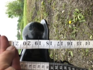

my quick measurement on not so perfectly flat terrain is 23" to top of shank.

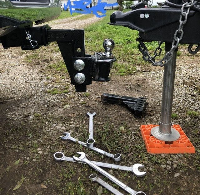

I had to buy a specialty 6" drop shank from fastway for me e2 setup.  My trailer actually has a low hitch height.  The previous towing veh used a 2.5" drop shank and the lowest setting was not low enough to tow the trailer level.    While I dont use the lowest setting on the 6" max drop, I will tell you the difference in hitch height from my 2002 chevy to my 2020 chevy was an increase of just under 4".    I calculated the 6" drop would put me in the sweet spot.

So some context on the pictures,
top of shank is 23".   Per fastway the couple should be no more then an inch or so from the hitch height at level. Level hitch coupler is like 20.5".   The drop shank got me to about 20.5".   There isnt much squat but the squat goes away with the appropriate washer setting and equalizing bars loaded.
To reach 15" coupler height, its going to look really odd lol.
