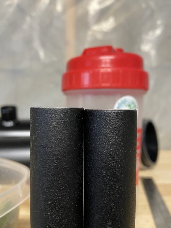

Another question... what’s the clearance on the main bracket and the alternator pulley? When I fully tighten the main bracket bolts the pulley and bracket are touching... I removed the top long spacer and bolt and it seemed to open up the gap between the two but only about a 16th of an inch... I measured the spacer and it appears the top one is a 16th of an inch off of the what the numbers are in the directions. Just curious if the main bracket and alternator pulley are really supposed to be that close or if there if more of a gap you think?
Found the issue. New spacers being sent from procharger. That about sums up how this installation has been lol
