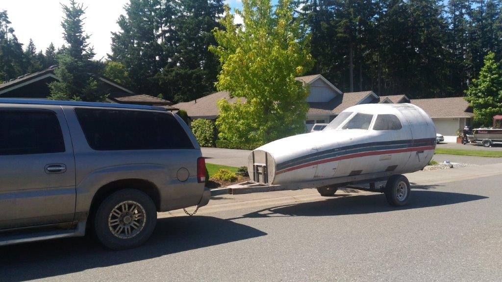

One other thing that I should add is wind resistance can really rob your fuel economy at highway speeds.  A travel trailer is traditionally shaped like a brick.  My neighbor's grandson designed his camper with aerodynamics in mind.
