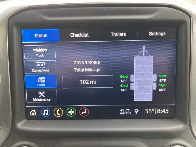

As for the weight distribution hitch, I would definitely get one.  That's still a pretty good size trailer.  If you have the advanced trailering system, I'd also create a profile for your trailer and I'd get the GM trailer TPMS sensors and have them installed on you trailer tires.  It's nice to have that info available as you're driving.
This is what the trailer TPMS display looks like on the infotainment screen....
