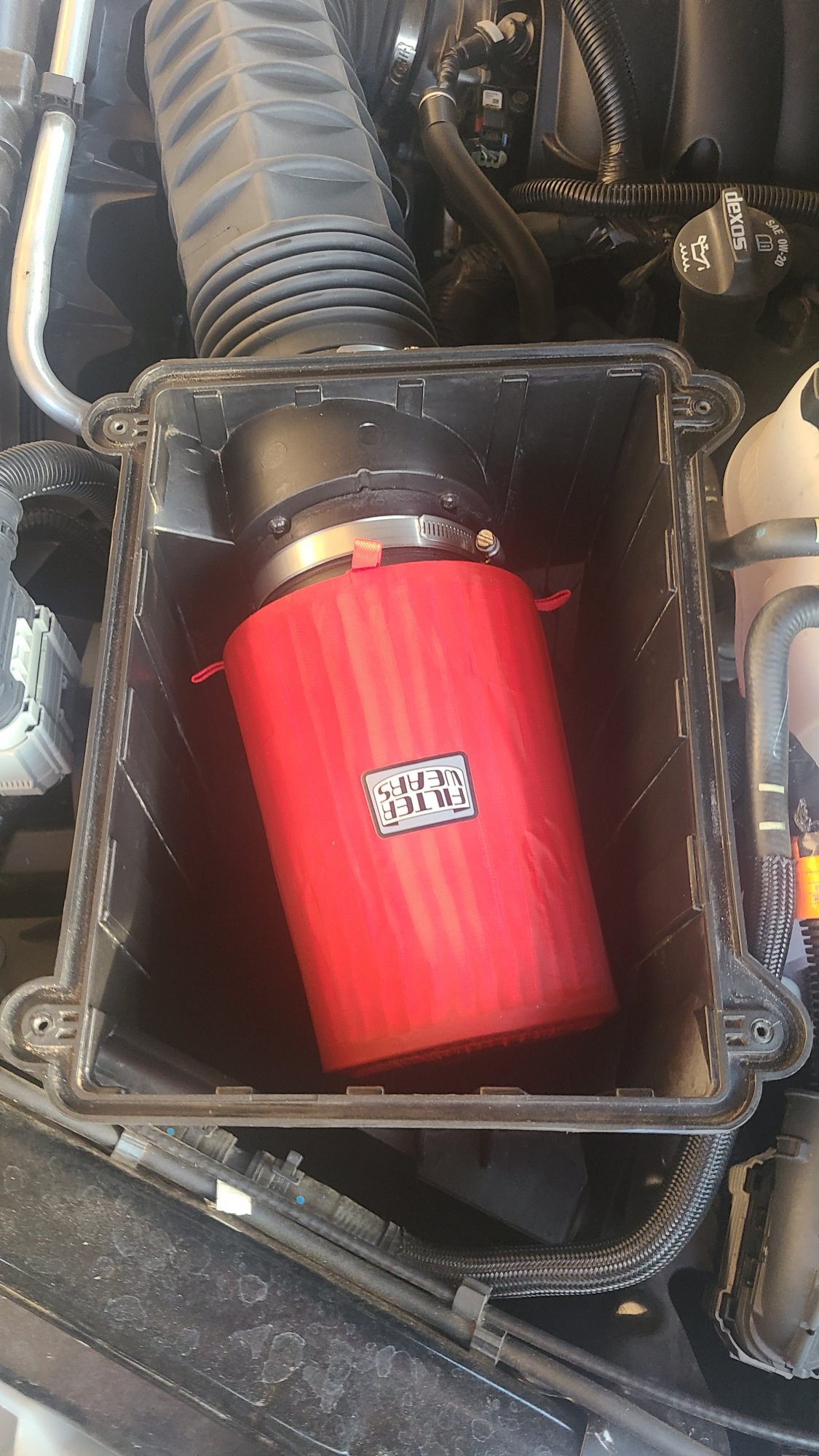

Have the intake and exhaust installed from the factory.  Noticed the air filter was picking up a good amount of larger debris (bugs, leaves and such), so I decided to add a FilterWears pre-filter, as I have them on almost everything else I have.  Took some measurements (5" diam top, 6" diam bottom, 7.5" long).  Closest fitment I found was P/N K265 for K&N RC-5100 filter.  Rolled the dice.  Ends up fitting snug, but perfectly.  They did send me the wrong color (ordered red to match the filter), but I'm sure they'll make it right.
https://filterwears.com/products/filterwears-pre-filter-k265-for-k-n-air-filter-rc-5100-57-1058-63-9023-57-9020?_pos=1&_sid=9bb52f367&_ss=r
There are other companies that make pre-filters for RC-5100.  Obviously can't speak to fitment of these, but I'm guessing you'd be alright.

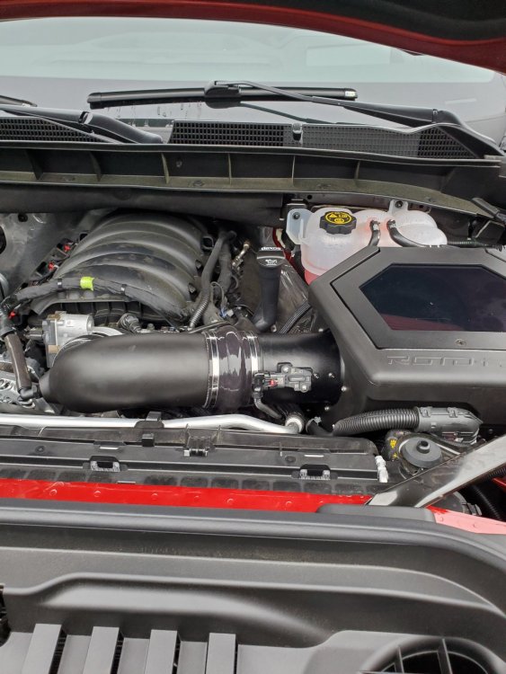

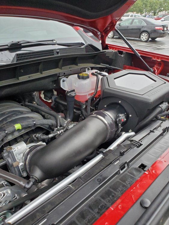

I dropped 2 tenths to 60 with the Roto-Fab so I would say their claims add up.
The GM intake is more conservatively designed it seems. The ribbed intake tube and the dry filter eat up some of the gains that otherwise would be had.
