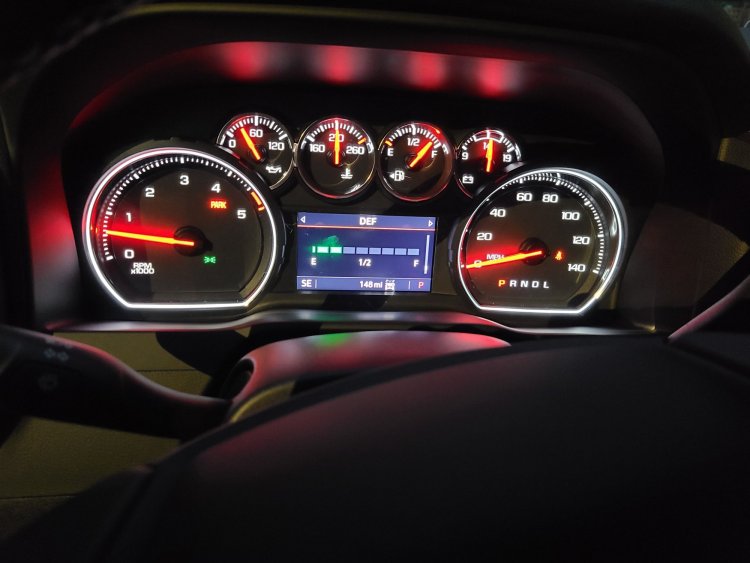

What are other owners of a 2020 Silverado 2500 Duramax getting as far as DEF usage?
I have a 2020 Chevy Silverado 2500 Duramax that is only getting about 300 miles to a gallon of DEF.  My last pickup was a 2016 Silverado 3500 and I was getting over 1,000 miles to a gallon of DEF.  Pulling the exact same trailer, with the same loading, going the same route.  Without a trailer, just driving around town I am getting a whopping 400 gallons.
I have taken it to the dealer a few times and they say without an error code, there is nothing wrong.  They have updated the software a couple of times and given me a bulletin from Chevy that said higher usage might be from changing environmental standards.  Looked up the standards and they didn't change that much.  I assume that is why they went from 5 gallon tank to 7.
Is everyone experiencing this same level of usage with the 2020 or is my "unique"?  Or did I have an unusual experience with the 2016?  I have only driven Chevy Silverado diesel pickups and have never had any issues but this experience is just about to tip me over the edge and consider something different.

Information: The current 2020 Silverado/Sierra is the first to have a DEF level gauge on the IP. This is the first time a customer can see a representation of how much DEF is in the tank up to the full capacity of the tank. This gauge does not operate like the float style gauge that you have in your fuel tank. Because of this, you may see some fluctuation in the gauge. It may also take a few key cycles to register the correct amount in the tank after a fill event. With the new segmented DEF Level gauge, it is possible that after adding 5 gallons (18.9 L) of DEF that the gauge reads as a full tank after the fill event. However, if the actual level of DEF is just entering the last segment on the gauge, the gauge is likely to drop by one segment shortly after driving after the fill event. This could give an initial impression that the vehicle consumes a lot of DEF.
