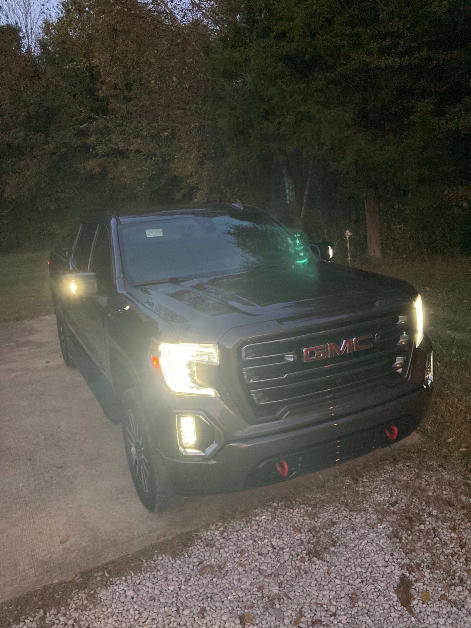

All lights mod with selectable fogs
4 hours ago, Ghost Sierra said:
I just want all lights including tasks and cargo lights to come on when I unlock the truck.
Me too! I looked at the diagrams a few weeks ago, and I couldn't figure out how to make it work. If you could find what made the normal unlock lights come on for the time period you selected in settings, you could theoretically just jump from that source to the Cargo Lamp Relay. However, I'm thinking the BCM does all that timing and telling what lights to come on when the truck unlocks.
Yeah this would be a BCM programming thing. Wiring it to get it to do what you want would mean those lights would be on anytime the other lights are on.
Seems like someone way smarter than me could make a pigtail out of a Raspberry Pi or something that could sense signals from the BCM and do something like this:  when a signal activates the lock actuators and the headlights/other lights at the same time THEN turn on Lights X & Y for 90 seconds or until the truck is shifted out of Park.

I installed this on my 2021 SLT, works as advertised.
