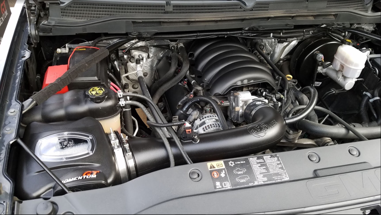

I went with the AFE GT based on BB's dyno test and talking to a couple other guys. If you are truly going after more HP/TQ, spend your money on a tune and new headers/exhaust first. If you want something that makes your 6.2 sound even better (I really love how it woke it up - not overbearing but a great balanced rumble), makes your engine bay look cool, and *might* give you some additional gains then go with the AFE GT. I also like that it opened up my engine bay more to get to other areas if I need. I added a catch can after I took this picture as well. Can also chat about that if you have questions.

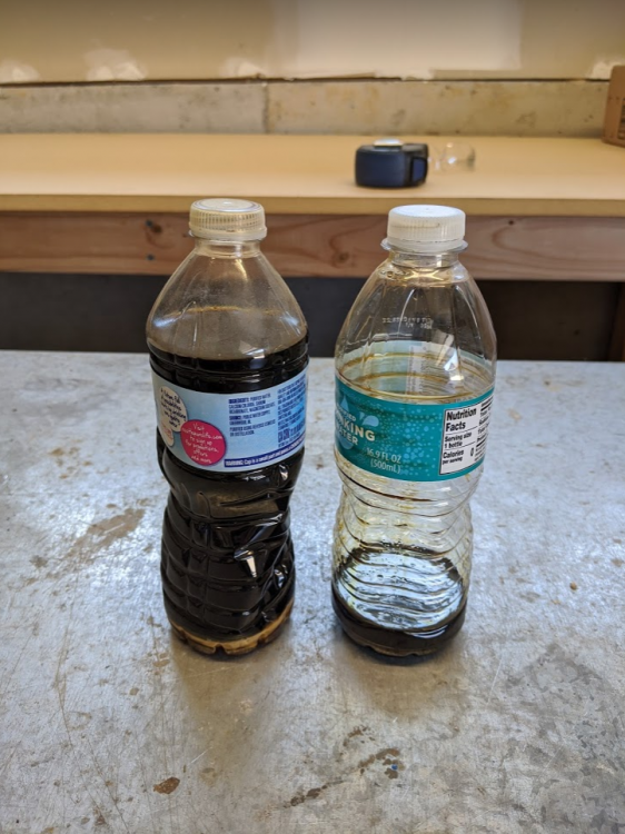

Yeah a catch can really is an entirely different conversation. I put mine in after the top end of my engine had to be rebuilt (coolant leaking internally through both heads - GM covered the bill). Figured with everything cleaned up and new, it was the perfect time to install one. Here's a pic of how much my catch can has caught in roughly 25k miles. Don't mean to derail the thread, just thought I'd make a quick comment about it since you mentioned debating installing one along with the cai. And take all this for what you will, I know catch cans are hotly debated. I just figured why not try it, could be a waste of money but certainly won't hurt anything.

For sure. I mean a lot of guys run the amazon one and works just as well as a elite supposedly. I may actually order one today. I did however see a few guys say that it voided the warranty by doing that. If I wasn't moving from my dealership I wouldn't be worried about it. I guess I could just take it off before it goes in.
