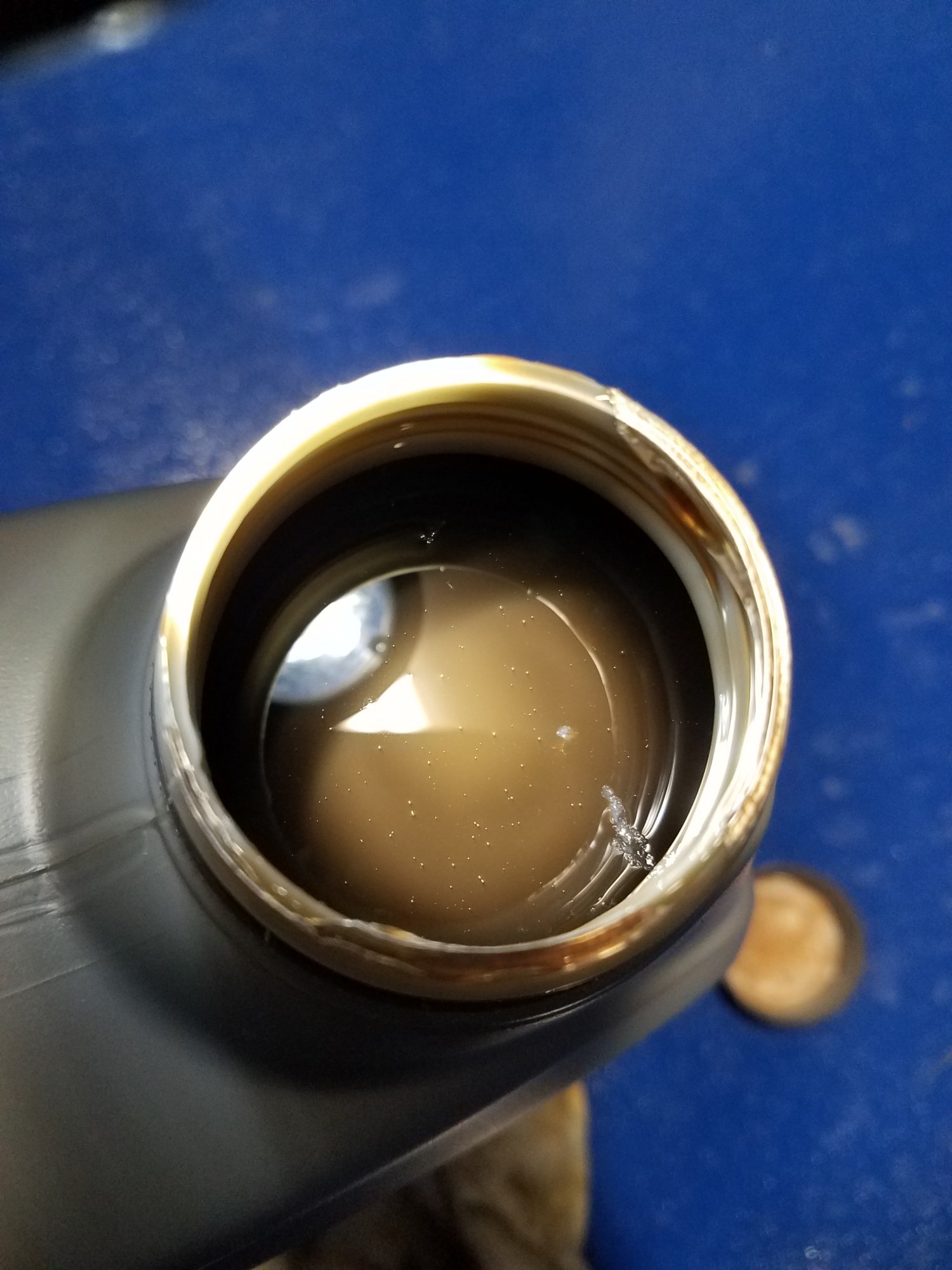

good info, how glittery is the oil on a bad trans from what you've seen.?
I wonder what the TC lock up data looks like on a good trans vs one that shudders
Edited by flyingfool
TC lockup percentage will stay the same.
If you graph slip speed you can see it but we use the PICOscope and measure vibrations then based on the T vibration determine shudder
However you don’t feel it really so people don’t come in for it. They come in because transmission no worky
