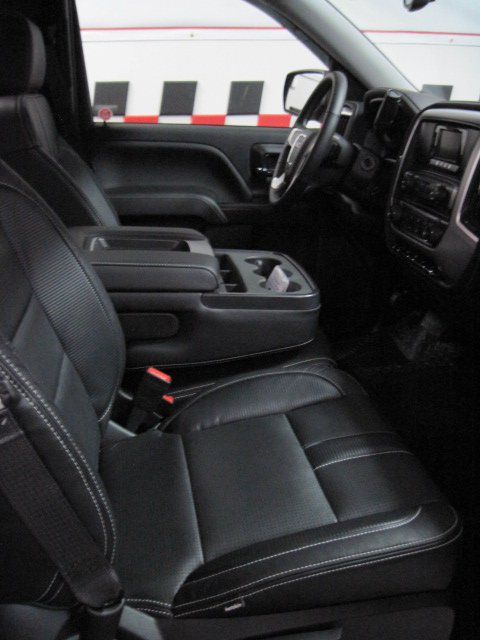

When I did them on my 2014 I bought them as part of the truck through dealer. I got heated as well. They had a upholstery shop do them. You would be able to do it yourself. The only problem I had was on the edge of the drivers seat the leather was delaminating on the edge from getting in and out. They looked very class though. I had what was called Cuda Combo. They very closely resembled the Sierra All Terrain seats with the Carbon fiber look leather on the bolsters.
Good luck and enjoy!
