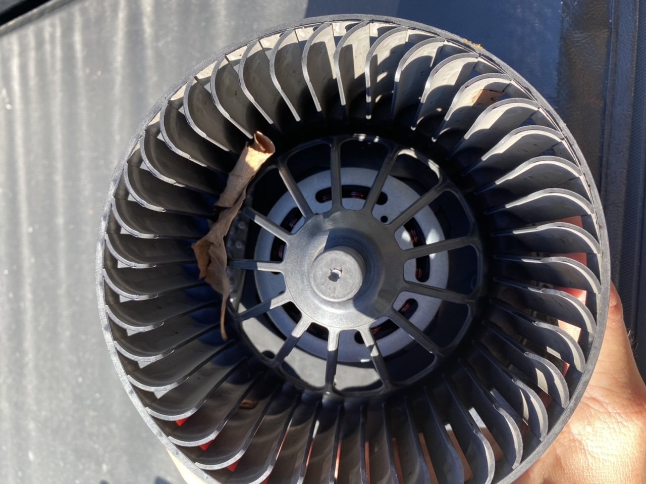

almost sounds like a leaf is caught in the impeller and causing it to be slightly out of balance. Not sure how accessible that is. Not sure if it’s worth waiting until it decomposes, which could be a really really long time in a non damp environment.

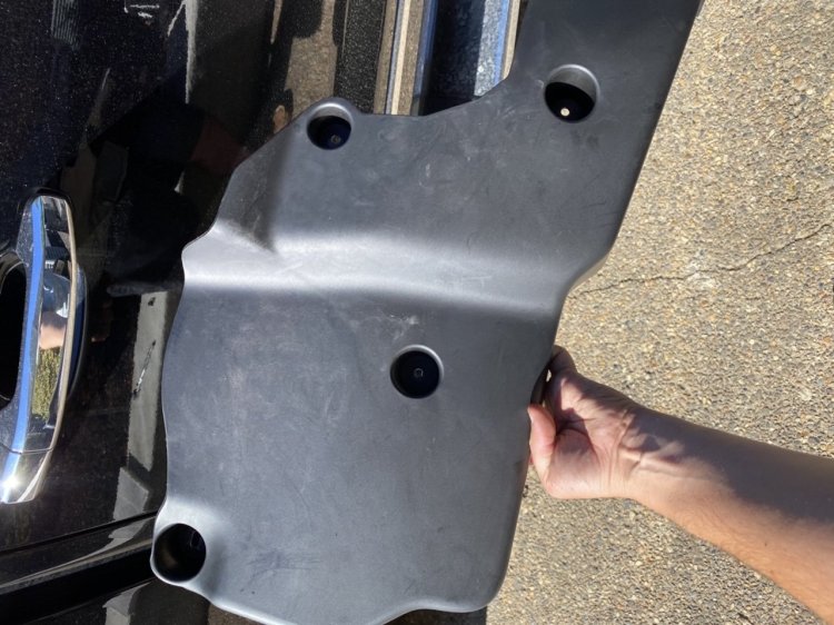

Ok so here is how you clean it.
it’s super simple, but I had a helluva time getting one of the screws out.
total is 7 screws.
You need to take off the big trim piece right below the glove box. There are (4) screws, you need a 7mm deep well socket.
they you have access to the bottom of the blower motor. Unplug the wire from the blower motor. Then remove (3) t15 torx screws. Then blower motor drops right out.
Pictures attached of the panel and blower motor.
