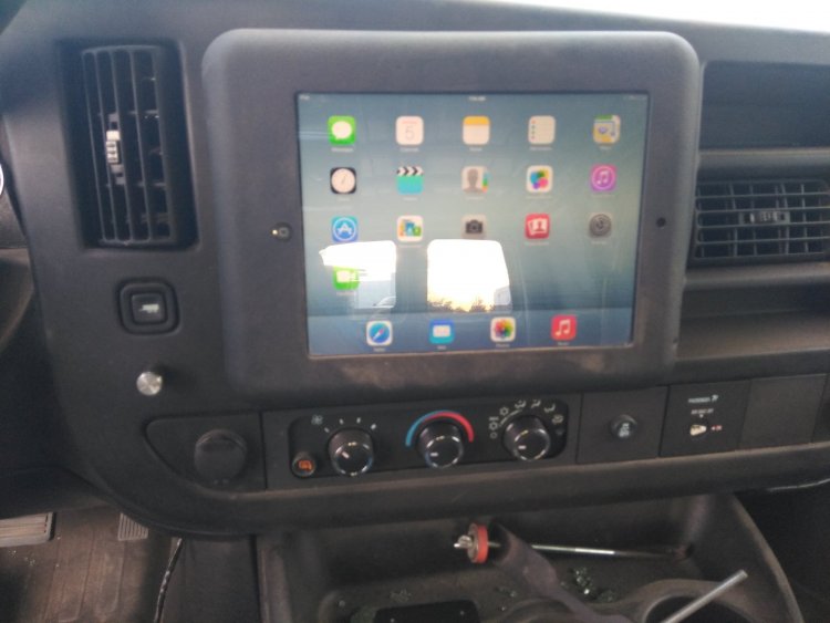

I have to charge the battery in the van somehow.  It is one of the very early prototype of their prototype fleet.  It has an iPad in the dash and only has 2400 miles with original tires from 2013.  If I can't figure out how to get it to run, I will probably convert it to gas and take the EV parts to use in another conversion to all electric using only batteries without an ICE.
If I have to take apart the battery pack, I will post pix.

The SoC percentage would be nice to know and I'm not aware of how to do that. I believe the early versions had a screen (there's a photo of it on this thread) and that have the SoC reading your looking for. No idea if Via child provide that now.
