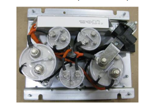

The document you provided about the A123 battery pack shows an Electrical Distribution Module (EDM) and this is what a contactor looks like (round with posts on top).

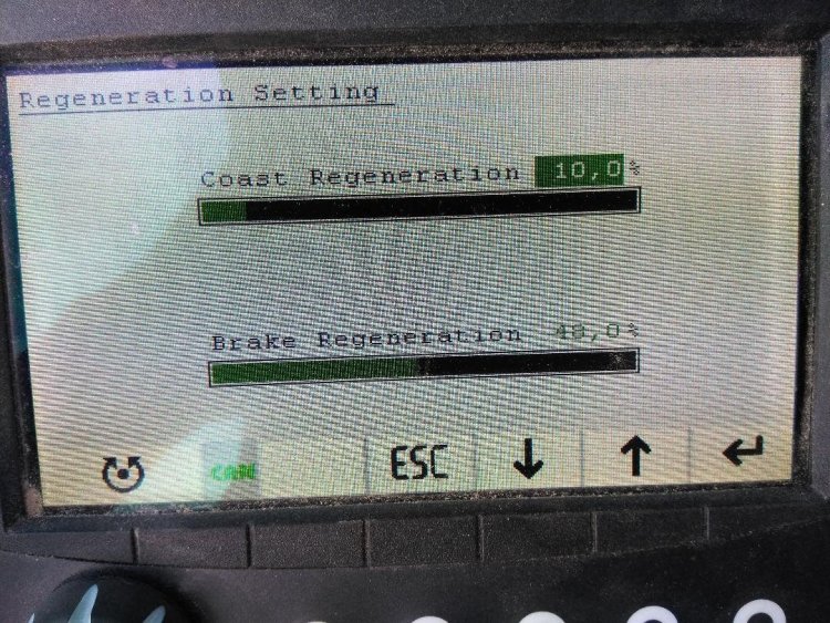

That screen is crazy. I put an aftermarket in mine, but I it didn't monitor any battery stuff.

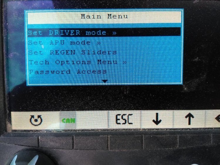

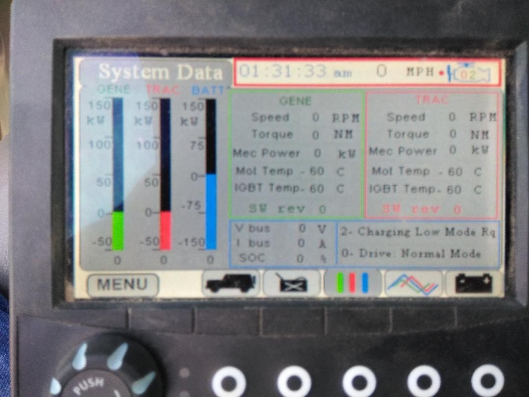

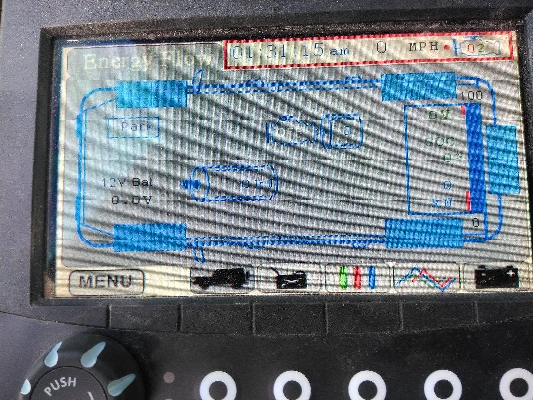

That display is original from VIA Motors.  Same with the iPad.
