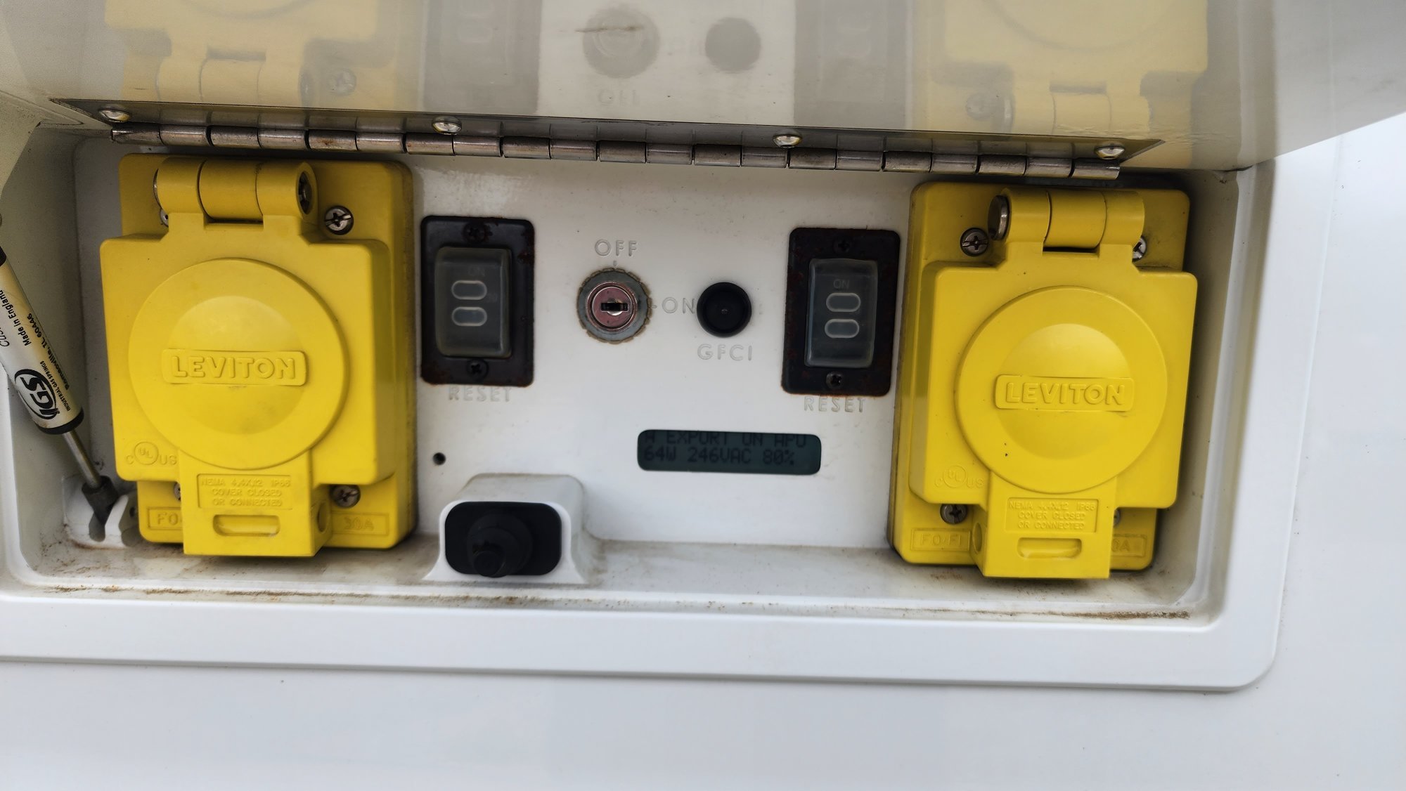

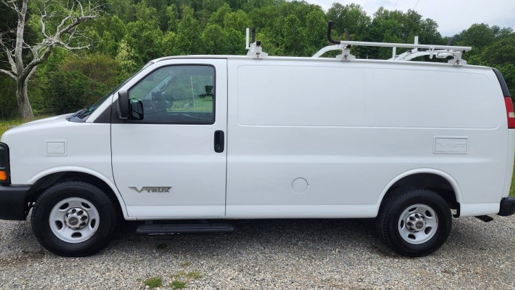

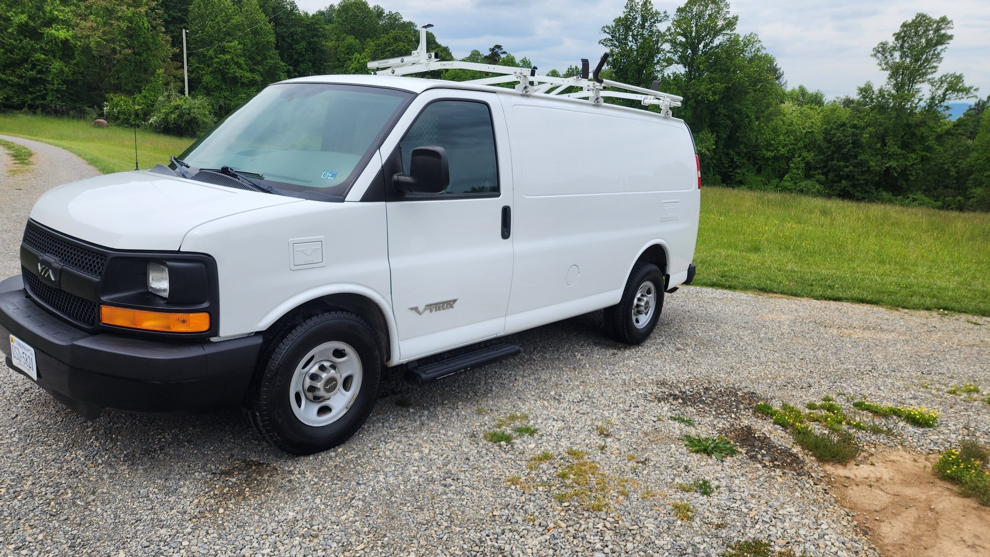

If anyone in here is interested, I currently have a 2014 Via Vtrux Chevy Express 2500 conversion for sale.  It has 68K miles with the 60amp export on it.  No issues other than some cosmetic issues(this is a work van and has been used as such).  Still gets around 30 miles of all electric.  This is a 4x2, no 4wd.  Makes a great in town delivery/repairman van.  $19K.  This comes with a 4.8L V8(instead of the V6).  If interested, I will post a link to the sale.
