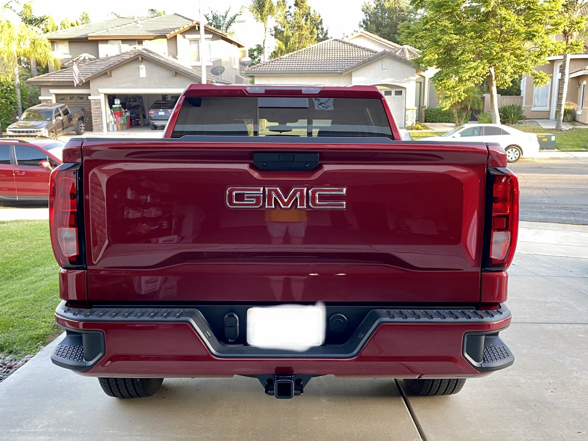

definitely taking that "Sierra" billboard off the tailgate. After the dealership throws their decals on(which better not be on) the truck starts looking like a European hockey jersey in my opinion.

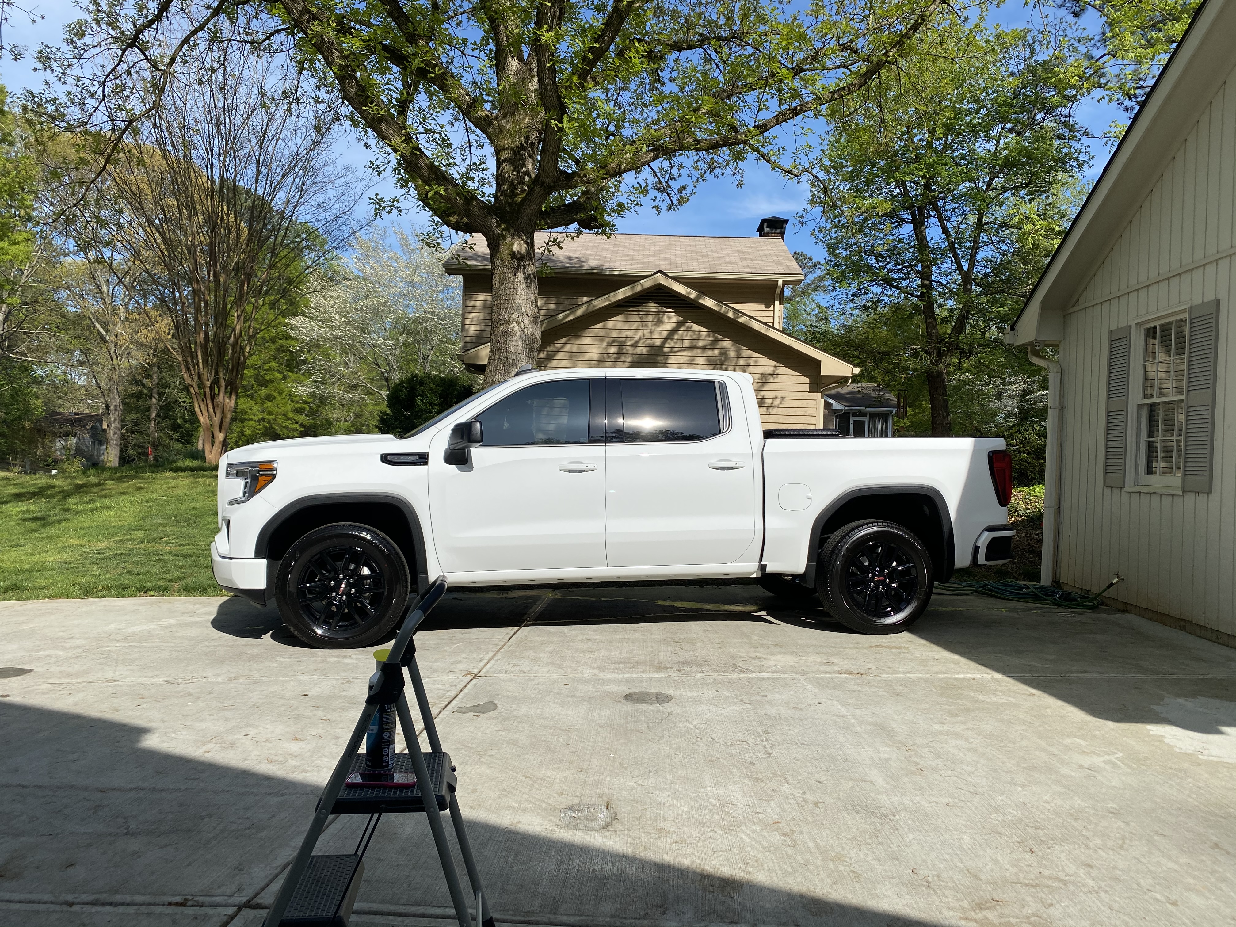

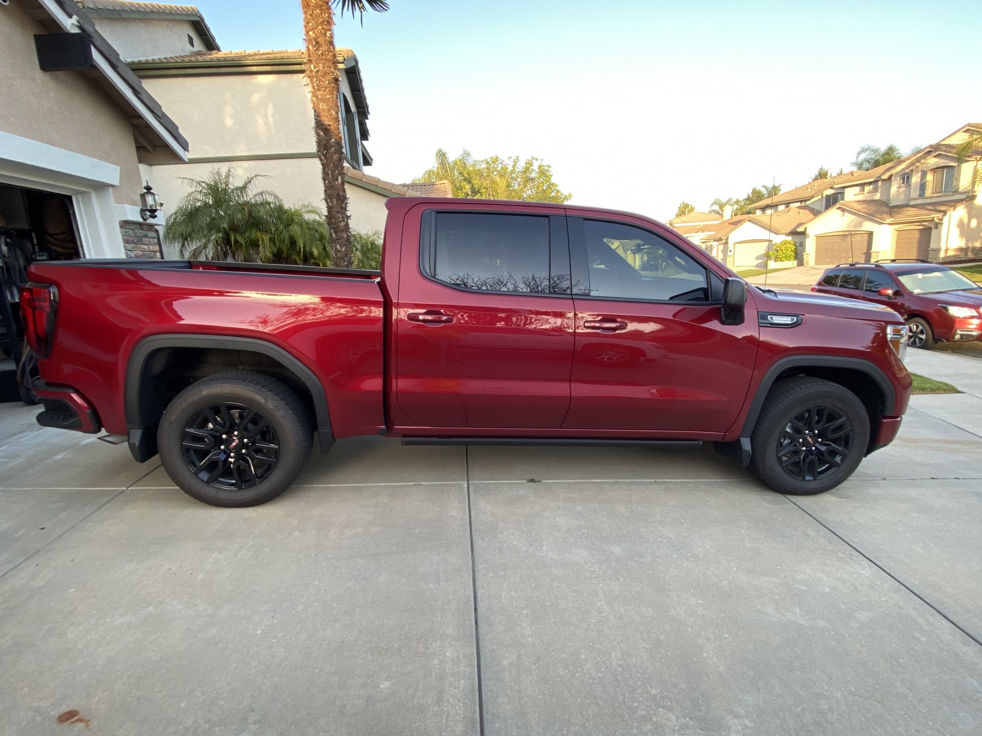

That was the first thing I did to my Elevation when I brought her home. Used a heat gun, then fishing line, then 3M adhesive remover.
The rear 4x4 badges had a little outline, so I just clay bared it off. Took all the Elevation badges off, the 4x4 badges, the Sierra badge...and of course the dealer sticker and license plate frame!

I used fishing  line as well...didn’t have a 3m remover. So I used Goo Gone and a thin wide Teflon putty knife so there would be no scratches. I took off the Elevation, Sierra and 4x4 badges. I want black GMC grill and tailgate logos...but the ones GM offers are black and chrome...and I want all black. I did get some black 4x4 logos off eBay though.
