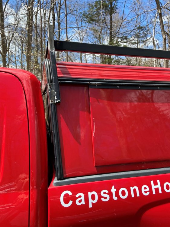

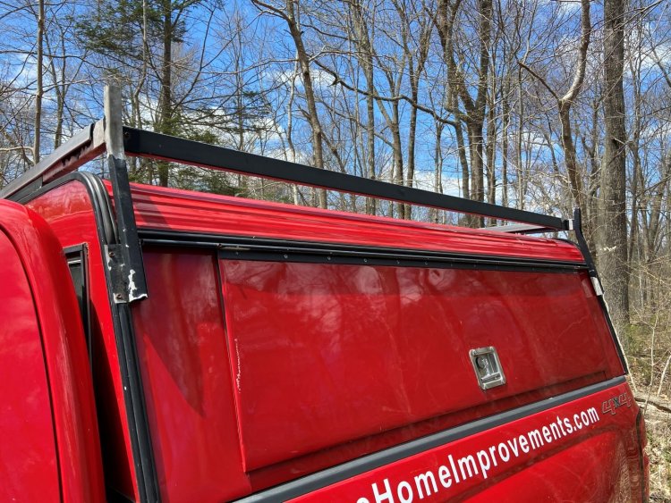

Thanks! Certainly a lot of info there but my utility cap is one of the aluminum ones that doesn't exactly fit all of the contours as nicely anyway. I took a couple photos of my current setup. I understand why a fiberglass unit like the Leer cap wouldn't work. I'm not looking to get a high end enough truck with the Multi Pro tailgate. I may just go to a closed dealer near me and take some measurements...
I don't think the footprint of the top of the box will be a big issue, its the spoiler.  Anything double or crew cab have the spoiler no matter the trim level.  That cap won't be able to sit as tight as it should as on your truck now and will most likely have a gap at the front, possibly hang off the rear.
