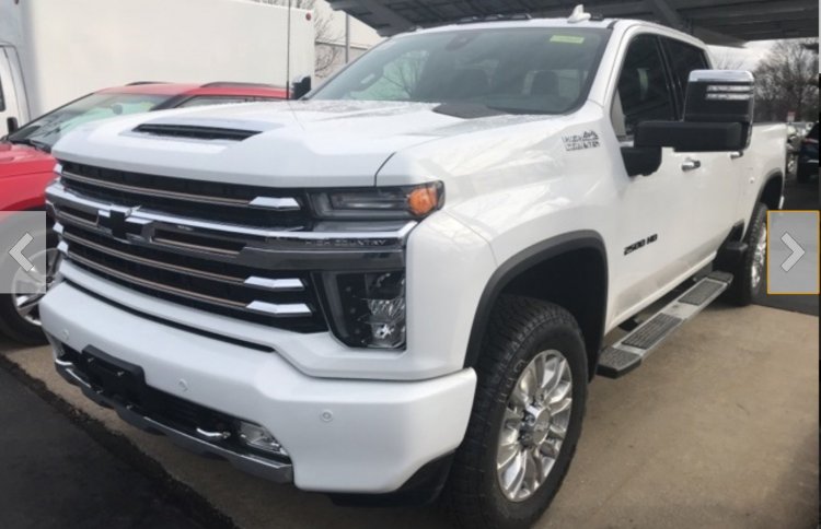

I just picked up my 2020 silverado 2500HD High Country.
Does anyone know the part numbers for these parts.  Dealership was no help. I have them in chrome and looking to get them in black and then paint the grille, valance, and door handles summit white.
Black plastic tow mirror covers
Black plastic hood vent
Black bottom window trim.
Any helps appreciated.
