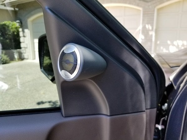

I put in the 3" Focal mid ranges (3KRX3 - Focal  3" 50W RMS). It was a tight fit, so not sure 4" will work without significant mods. To fit the 3", I just ground out the hole to just past where the indent lip is, and drilled new mounting holes. Held up for over a year now, and sounds awesome. So much better kick drums and mids.
Cool. im thinking of seeing if I can put them next to the mids inside the dash. Just not sure if there is any more room in there. Do you have yours running passive or active?  I have my fronts active and rears passive. Uses all 8 channels on my jl vxi 800/8.
