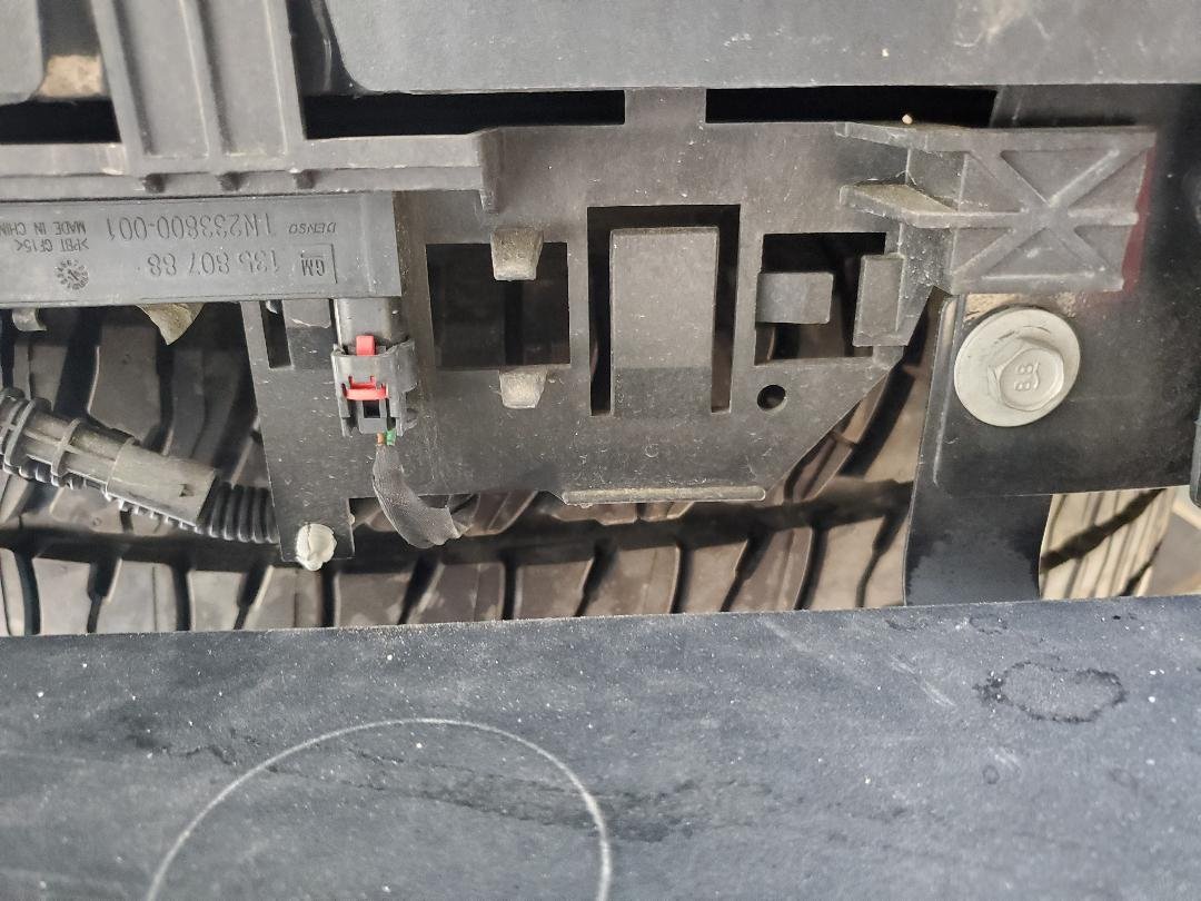

Yes, the receiver is not there. I called the dealership weeks ago and the parts guy pulled my truck up and said that all I needed was the sensors. The truck didn't come with them, so we both assumed someone had taken them out. So they gave me four new sensors. I am thinking at that point someone should have been saying, "Dude you don't have the receiver optioned for your truck." lol
Hmmm...That is quite odd.
