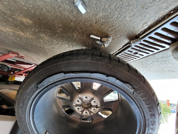

Late to the thread.   Just bought my first GM truck.  It had 45k miles and bridgestone tires.  I had an intermittent vibration at highway speeds and on curves.   I had Belle tire do alignment last week.  No luck, still there...
Went to Discount tire yesterday to try having balanced.  This is what they found.  This was worst tire, but all 4 had it on inner sidewall.
The lady recognized it as a manufacturer defect and called bridgestone.  They gave 150 rebate per tire so I bought a set of Coopers.

Wow They did not see the issue with the tires? I would never go back there.

Which model of Coopers did you go with? I plan on doing the same thing in the next few months.
Can you provide any information on what year/model Bridgestone's might be effected for the rebate?
