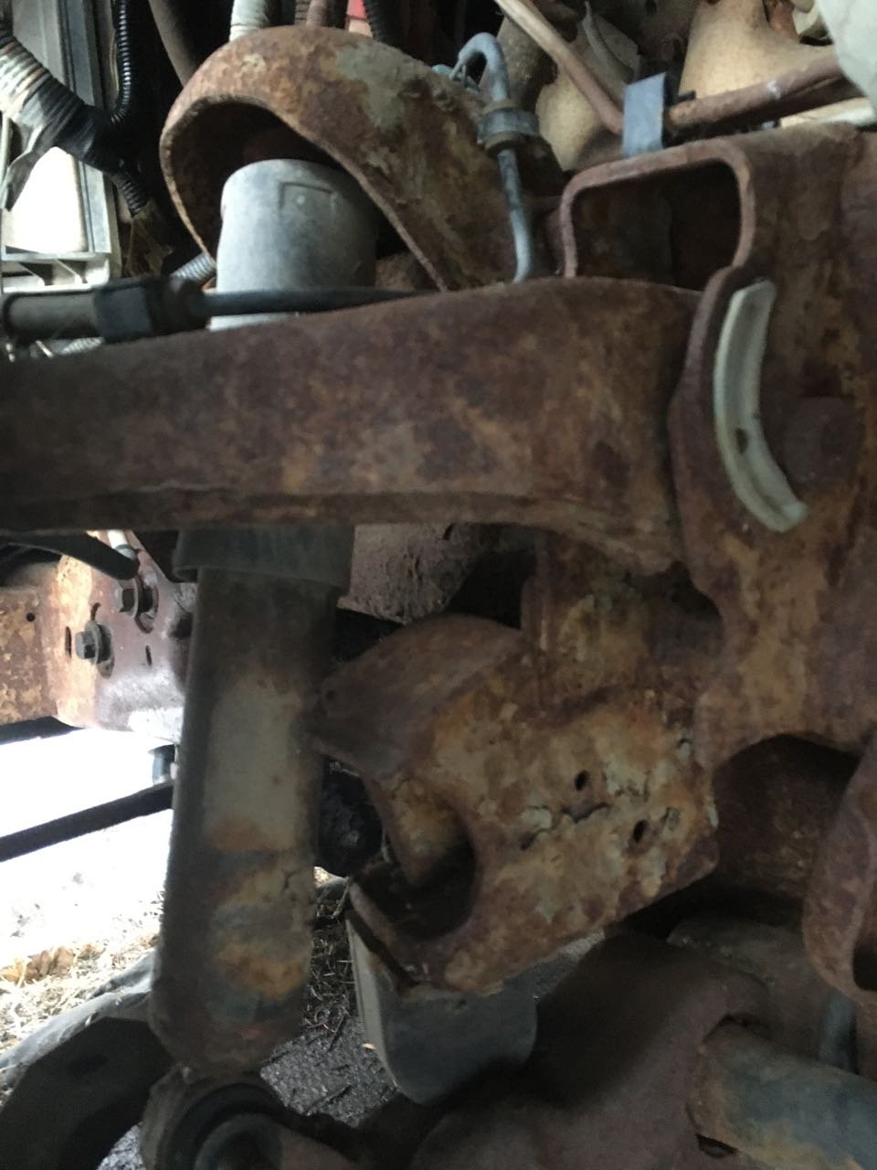

What can I do to get upper control arms off bump stops? I've replaced most suspension parts in the front end.  When I adjusted torson bolt back out the front end felt like it was on pogo sticks, so I put it back in rides ok till I hit a bump then BAM... And help is appreciated....thanks

Yes I bought the truck with the keys turned up like this, when I tried to correct this by turning the torson key bolts out again. After doing this the truck rode like it was on pogo sticks in rhe front jumping everywhere....is it not possible to put back to stock?
The pic you have in 3 & 4 show the keys are literally maxed out, so the suspension is at full extension when resting.  It's gonna ride like crap if it's anywhere near that configuration.
This is what it should look like (assuming stock components) at stock height:
The jounce bumper (the black rubber blob in the center bottom of the pic) is supposed to be slightly touching the LCA to be at stock height.
If you truck is pogo'ing when it's like this, then your shocks are shot.
If you want the truck lifted to it's current height, then install a proper lift kit.  Measure how high a certain point is, say the bottom of the front bumper now, then turn down the keys so the jounce is just slightly compressed by the UCA, then measure  again.  The difference (assuming that's the amount of lift you want) is the size of lift you want to get.
If you just go for turning up the keys and the UCA gets close it's bump stop like it is in your pics, it WILL ride like crap, and possibly damage the UCA from constantly hitting it.

Wow, thanks so much for the picture and all the insight!  Really helping me wrap my head around it all.....my shocks have about 5k on them, believe I put on Rancho rs 5000, maybe just not good enough shocks?
Edited by Rpeebles587
First, turn your keys way down so the UCA isn't hitting that stop, then see how it rides.  And if you go for putting on a proper lift kit, it likely/should come with or specify new shocks to go with it (they likely need to be longer than stock shocks).

Thanks davester!!  Got the torsion turned enough and got the uca's off the bump...wow what a difference.. it's been like that since I owned the truck, lol ....riding like a dream now, bout to roll over to 190,000 on the 2000 LT 2500
