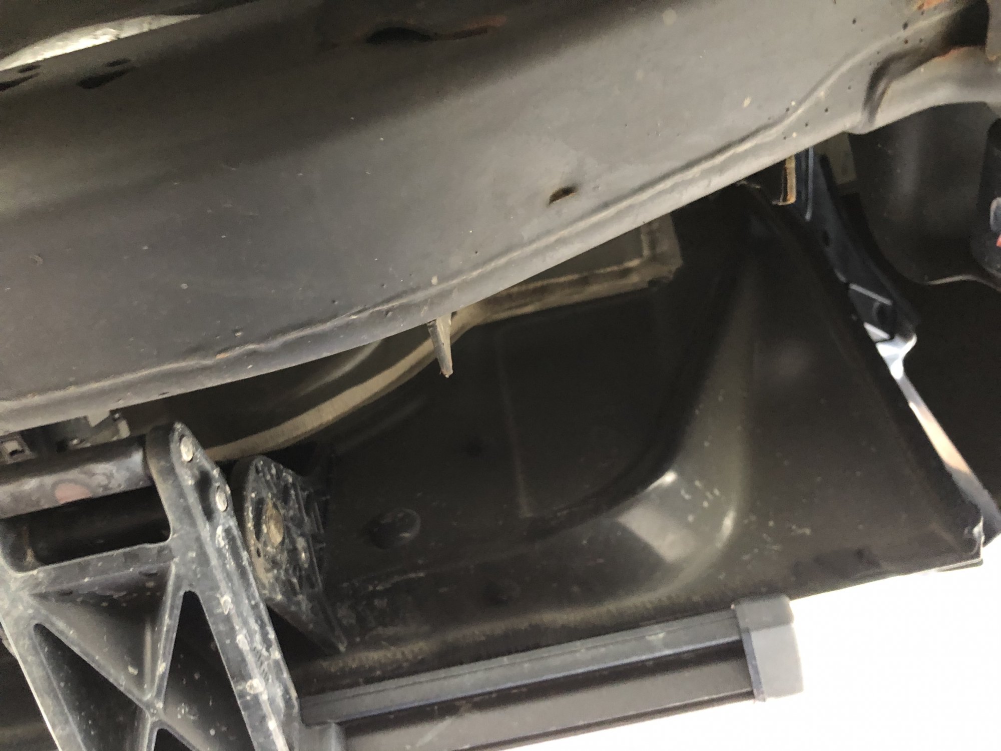

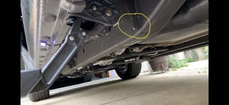

Ok so I spent some time under the truck today and figured out what my problem was.
To recap: I was unsatisfied with two things. (1) was the loud clunk the steps made when folding back up under the truck and (2) there seemed to be another clunking sound on occasion when driving around. Usually at low speeds from a stopped position. Sounded like a baseball was loose in the bed for a couple seconds.

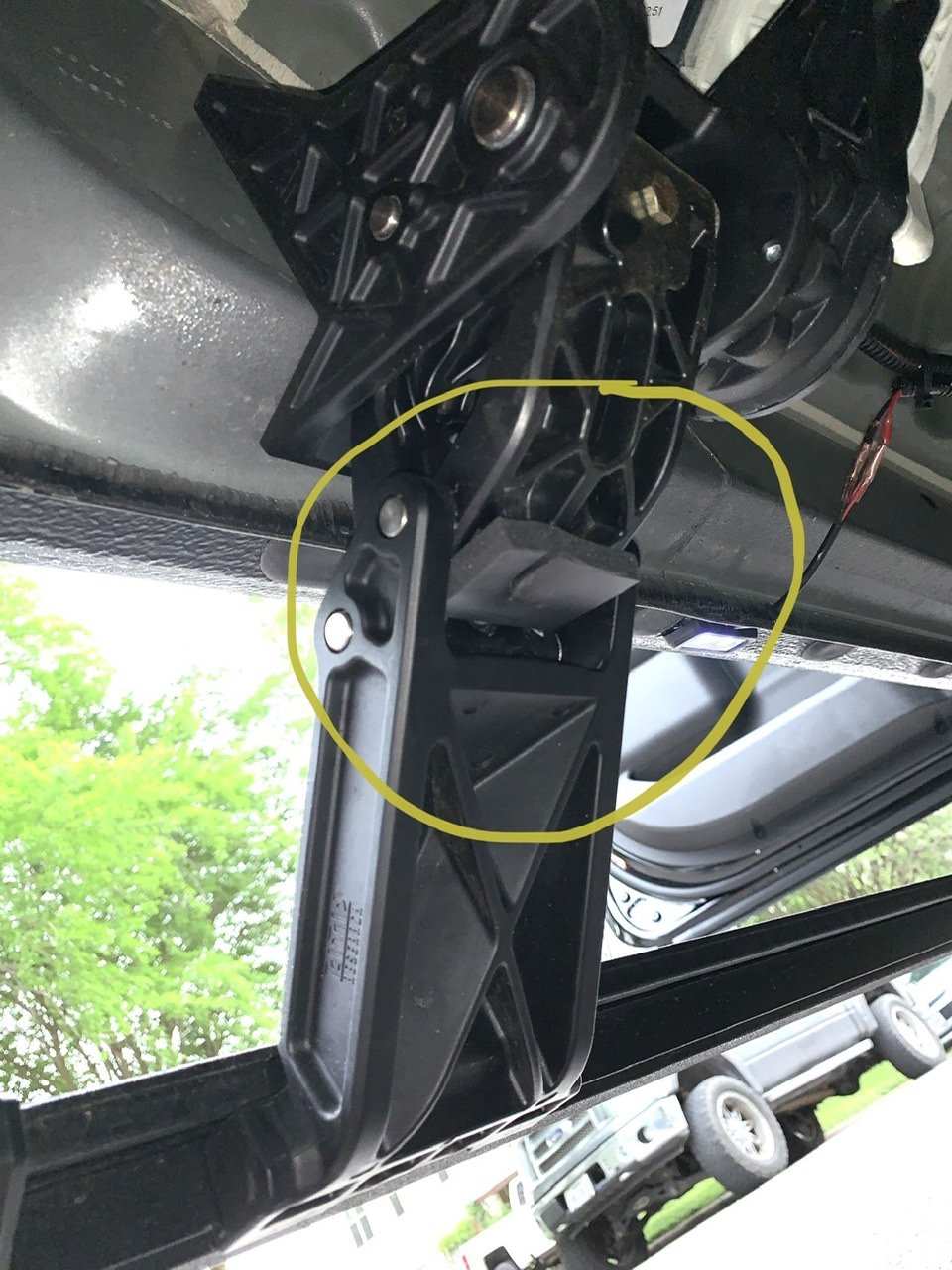

The rear bracket of my steps are installed further back than others or what the instructions say. While I prefer this look and the symmetry to the front bracket, it creates an issue when hitting part of the frame underneath when it contracts back up. Not the Step hitting the rocker panel under the door like I first suspected but it’s the step bracket.

Oh to add to my post above. I stuck about a 1.5” cut off of the sponge window seal onto the bracket of the power step. You can see the indention where it hits
this really really dampens down the sound. It’s actually quite pleasant now ?

As far as bracket position, are you one of the unlucky people that didn’t get a set of holes a little forward of the rear-most ones? My brackets clear that body mount by 6” or so.
I did not get the second set of holes either so mine are positioned on the last set. I do like them there as I also like the symmetry of the front to back positioning. That bracket is the one I cut a triangle piece off of and now have a nice gap between the rotating bracket and the steel support piece. Mine still made noise once in a while and when checking, my steps were barely touching the truck in the rear. I loosen the bolts on the motor bracket and added a 1/8 inch shim between the bracket and the truck, so now nothing touches and nice and quiet.
