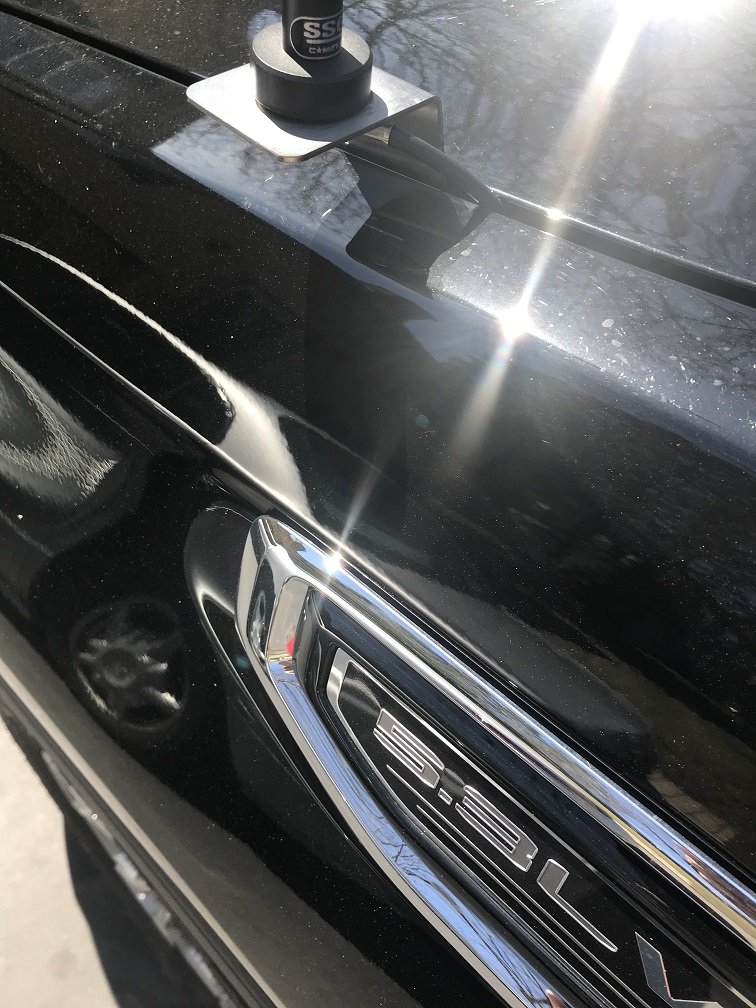

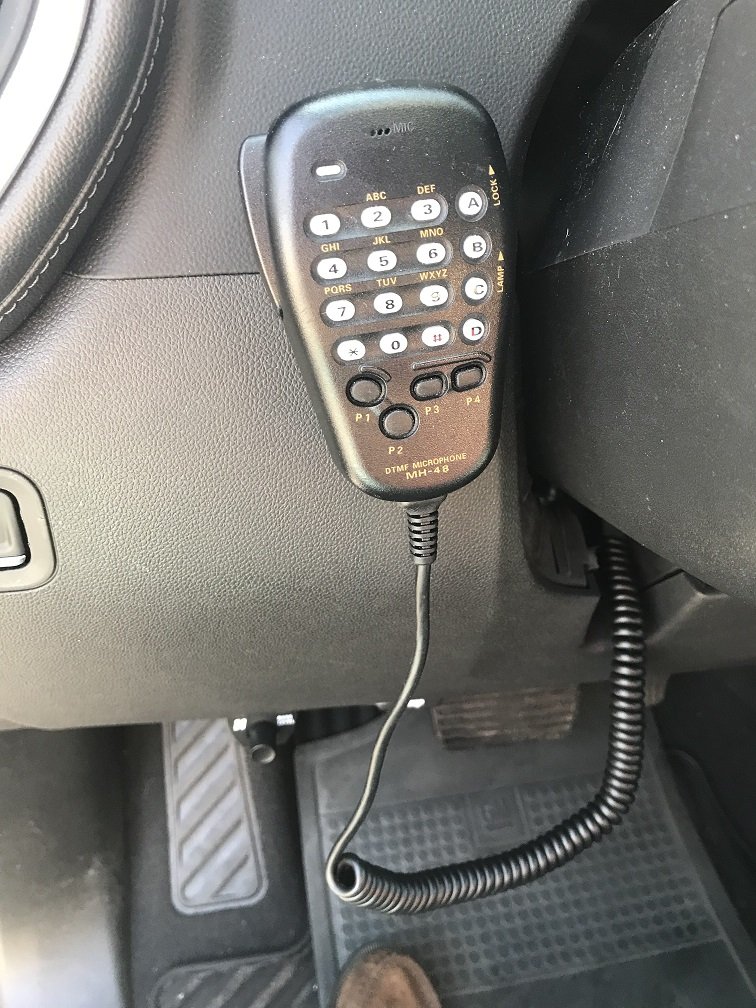

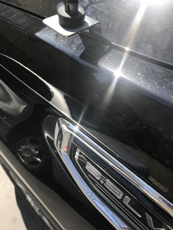

I have an FTM-100DR head unit mounted under the center dash with the body mounted under the drivers side back seat in the open area enclosed by the factory sub. Power is run from the battery along the passenger side and the control and mic extension cables up the driver side.   My antenna is mounted using a NMO fender bracket on the drivers side with the cable run through the firewall back to the radio body.
Because the radio body is semi-enclosed by the sub and the seat above it I have a MLS-200M10 external speaker mounted near the sub toward the jack.
I originally tried mounting the mounting bracket for the head unit using double-sided tape but it would only hold for a few days.  I ended up sliding off the bottom piece and drilling mounting holes and screwed the mounting bracket to it using backing washers. I had to shave the center tab and ream out the slot on the dash but it slid back in perfectly.
The only concession is that I'm careful to grip the head to support it when I turn it on or off so as not to put too much stress on the mount.
I hope I uploaded all 3 pictures correctly showing the radio head and mic and the NMO fender bracket.
