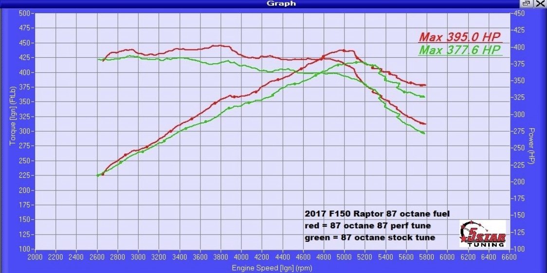

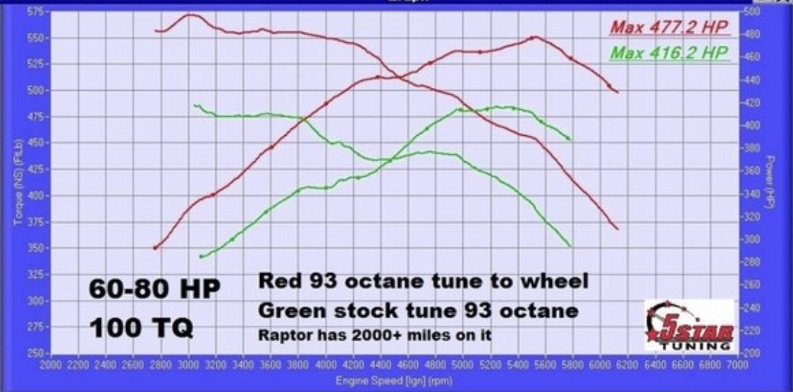

You can run it on butane and probably not ping at idle, but at WOT it’s common to see these engines pull 6 degrees of timing or more on 87. If the knock sensors are doing their job you wouldn’t hear it, but you’re certainly not getting what you paid for in the 6.2. Plenty of people have posted data logs for the last generation that bear this out. It’s a performance engine. Cheaping out on fuel defeats the purpose of it, and is likely contributing to the poor fuel economy you are seeing too.
As far as the Raptor...define “runs fine” because the dyno charts tell the same octane story, but worse.
Stock tune 93 octane, 416hp
Stock tune 87 octane, 377hp
