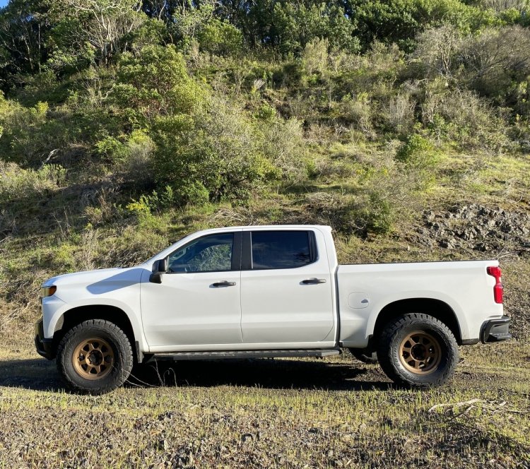

I get a lot of questions and messages about my truck and a few members asked why I don’t have a build thread, so I’ll list all my mods and pics in here for everyone’s viewing pleasure.
My goal with this truck is to keep it clean and practical but do somethings that are totally unique and custom. It’s my daily so it’s mostly used on road but we go on family camping trips when we can so it’ll have an overland style to it. I’m in construction so I’ll be adding a few things to help with tool storage as well.
Here’s how she currently sits...

2019 TB Custom
5.3 6 speed
Current mods:
Entire truck de-badged
Katzkin leather interior black with white stitching
Flowmaster fx catback exhaust
Go rhino running boards
Sealight led high and low beam headlight bulbs
Ridged SAE led fog lights
Atturo trail blade mt 35/12.5/18
1.25 “ wheel spacers
Black extended wheel locks
Eibach Pro truck struts and springs
