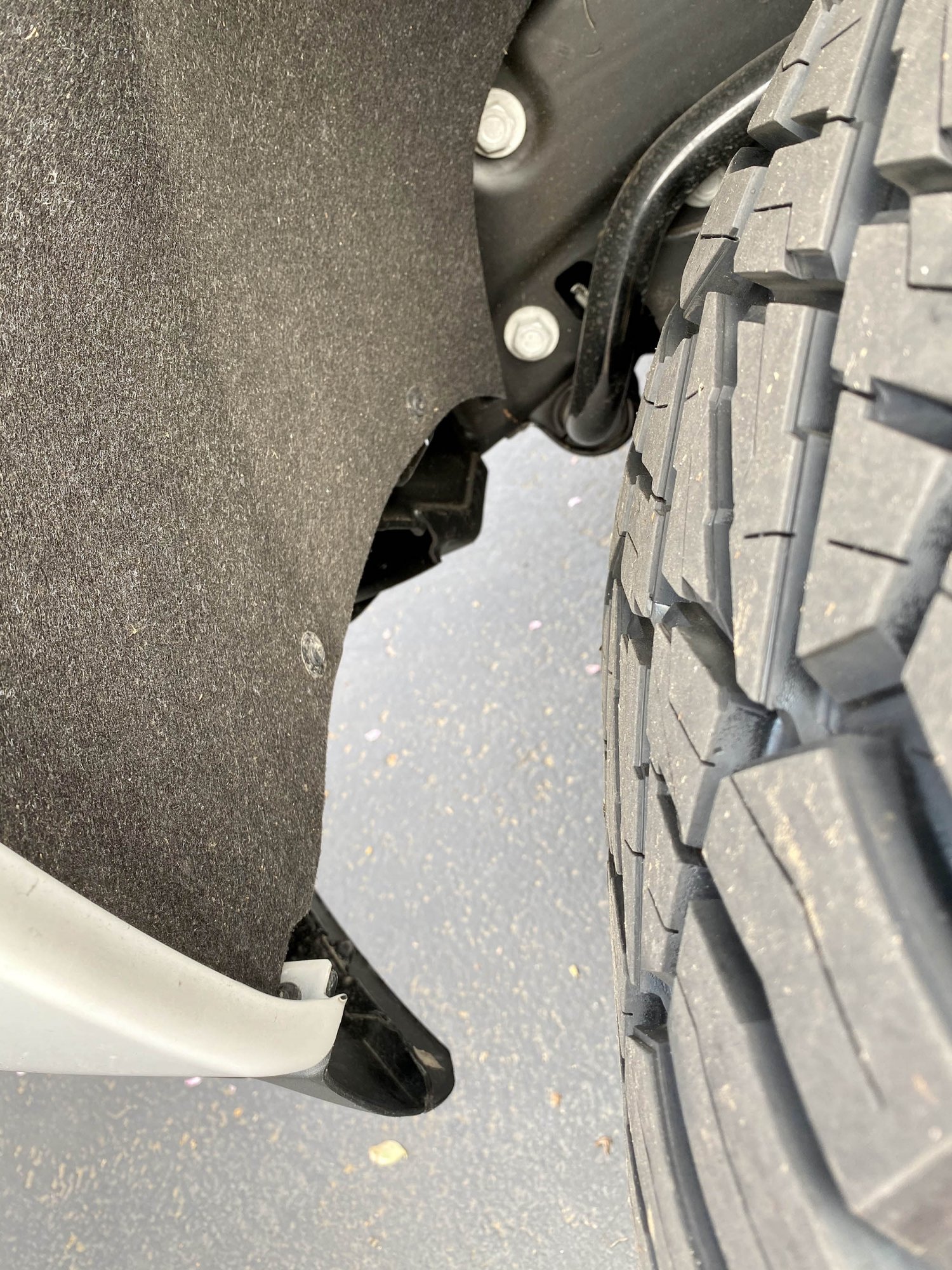

Yeah I think you have a small chance of it clearing but it will be VERY close. For reference back to my setup, my tires are an inch wider and my offset pushes the tire out an inch further, so that means I'm about 1.5" pushed to the outside than your setup would be. This would make clearance more in your favor.
However, with that being said, I know a lot of people don't like or want to trim, but the trimming I had to do looks pretty darn good. for the front of the wheel well, you'd never know it was trimmed, and the only way you'd notice the mud flap is if you were looking directly at the inside of it from 2' away. And worst case scenario, if you wanted to revert it back, buying a new mud lap would be an easy and inexpensive item. I also didn't trim any part of the mud flap that would be visible from the exterior so that it still looked factory.
