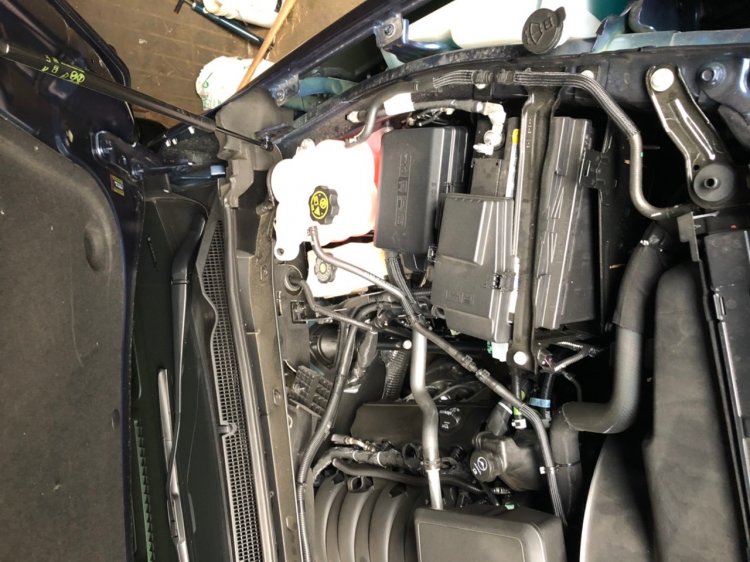

I added a second alternator to my 12 dmax... a dc power 270 amp xp. Tied into the factory alt wiring with factory connectors and added the bracket and idlers.... new belt and new charge wire to the second battery. Shouldnt be the hard, I did add fuses on the battery as well in case of over amps to prevent a fire... works great.

My bad what I meant was i put a 300 amp fuse to protect the charge wire in case more than 300 amps went through it so it didn't start a fire. The charge wire was I think 0 gage. The bcm controls the charging..... it all looks factory. The point is the op could get one alt like I added and it puts out 125amps at idle.... hairpin stator.

A guy on dmax forum made the replacement charge wire to look factory and the plug in wire for the alt to turn on.... I bought the passenger side battery fuse block and modified it to fit the drivers side and added the large fuses... ideally you could have just replaced the stock alt but since my new alt puts out 125amps idle and 270max, not sure I would trust the stock charge wire, I would replace that. Also not pictured I added the stock ground off of a chassis frame as it was twice the size from the firewall to the engine as my stock one.
