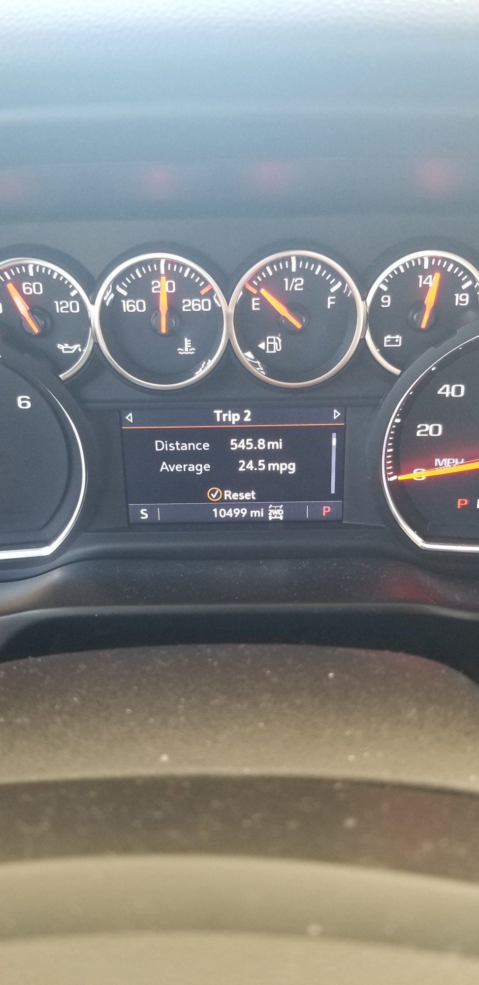

I'm just fine and dandy with DFM
Thos is with 89 octane
I might possible could've squeezed 600 miles out of a tank! That's incredible compared to 375 miles as before on my 07 Classic, that got a damn respectable 17/19
