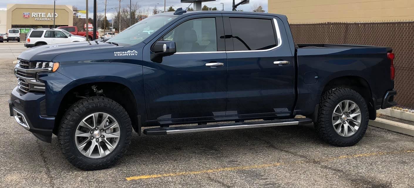

Yep, of course I had them add an additional 1" on the front to reduce the rake and added 35X11.50R20 Ridge Grapplers to fill out the wheel wells.  All together I was under $3k out the door.
Very nice. What level did you have them add? top or bottom mount? The tires mounted on the stock wheels it looks like?
It is a Traxda leveling kit.  It has a 1" U-shaped bottom spacer and two plates for the top.  The plates on top can be staked to get the height desired.  We just did the bottom spacer to get about one inch over the TB lift.  The tires are on the stock wheels, the offset allows the larger tires to fit without rubbing.

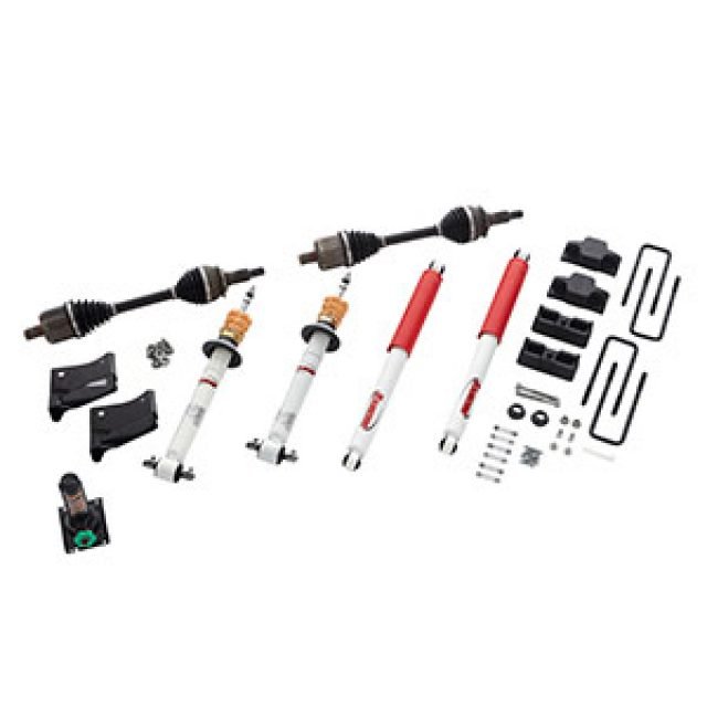

He first told me something around that price, but when I told him I wanted the AT4 "lift" which has the longer axels and all the other stuff, that's when it became the $1875. Which level kit did your dealer use if you don't mind me asking? no funny vibrations or anything? CV angles will be no issue?
Why is there longer axels? The “lift” is only a taller strut right? The arms aren’t wider as would be with a long travel. I’m not familiar only curious. The lift you’re describing for that price is a VERY good price. I race as a hobby and my half shafts are more than that whole lift + instal so that’s what I’m comparing it to. Post a pic when completed I’m sure it looks awesome!
I am fairly new to the whole life thing too. I also wonder why, when you can get an aftermarket 6"-8" lift and they reuse the half shafts. Here is a pic of what it ceoms with.
Now that I see the picture I remember it . Because even on the Lifes they usually do a drop down bracket for the CV angle. Something to consider when I was looking for a Lyft for my truck was the angles. By that I mean putting a taller strut in the front required me to get different upper control arms so that my geometry was correct for cam and castor and overall alignment plus stress on the ball joint. NowI don’t off-road my truck so maybe that’s not as big of concern but going with a new upper control arm and a taller coil over was totally worth it as the truck rides amazing!
because on a good lift kit they drop the differential down same amount their lifting....so it rides at factory height
