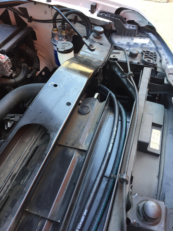

i'm gonna try running this full flow on my truck next. no bypass, just straight thru. i tried a spin on Derale adapter, work well but i feel the anti drain back valve built into a spin on filter is restrictive and causes the trans to operate at 185 degrees. i like to get my temps down to 145

OK just completed the bypass valve with a stock spin on filter, the anti drain back valve may not be an issue yet, i will run it for 500 miles then cut it open to confirm its filtering...
before the bypass valve i was operating at 185F with the trans thermostat deleted too.  now I'm back where i was after the T-stat delete (135-145 F )

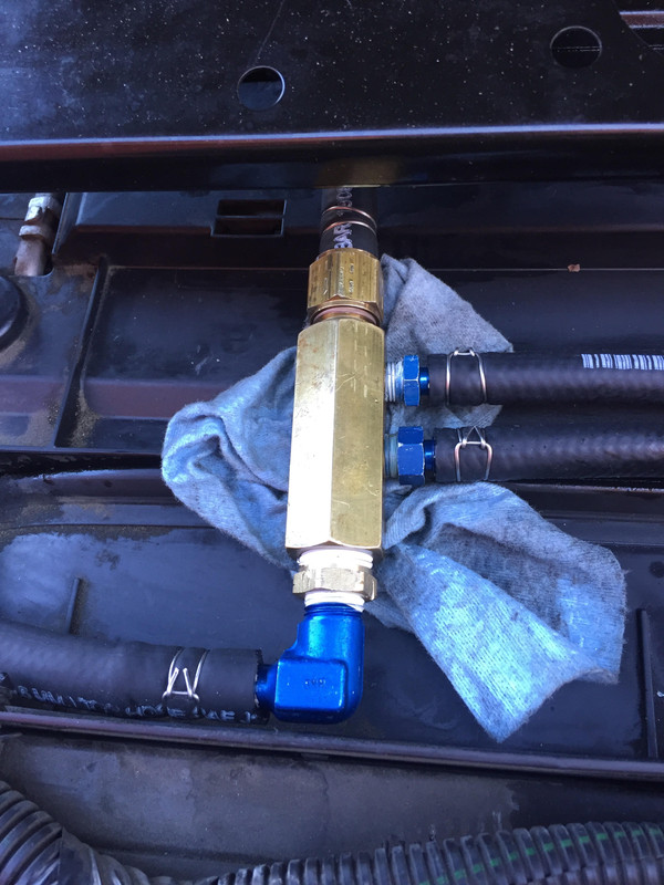

the by-pass valve is a piece of brass machined to accept input and output trans cooler lines, prependicular to this, are two 1/4" fittings that feed my remote spin on filter.  inside the brass valve is a bypass hole  of 1/8"  separating the 1/4" npt fitting, and creating a pressure differential for fluid flow. the valve can be Purchased from Frantz FIlters.

the Allison is a by-pass filter, theres no need to drop and drain the pan once you got a spin on.  my current set up cost about $80-90 , but the bypass valve is very important to maintain the trans cooling function , without it it will overheat.
