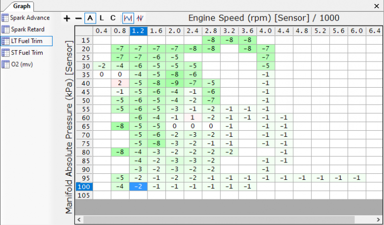

ic3man5 Posted May 20, 2020 Author Share Posted May 20, 2020 On 2/8/2020 at 6:40 AM, Doublebase said: But does that make sense to you? A vacuum issue would introduce air into the intake, the computer would compensate and add MORE fuel, not take away fuel, right? So you'd have + fuel trim, not negative. Vacuum leaks skew the fuel trim positive. And there is no PCV valve on these trucks, it's a fixed orifice, it won't get any larger and cause excess flow. You can replace it, but it's not a PCV valve. And if you did have a vacuum leak in that part of the system, I think it would cause a misfire at cylinder 5 (because the PCV line dumps right above cylinder five at the intake). If you have a catch can, potentially you may have a leak at one of the lines causing a vacuum situation, but I still think your fuel trim would trend +, not -. I could be totally wrong, let me know what you find out/how it goes. I think I've come to the conclusion its a vacuum leak, high pressure pump is going bad, or fuel injector is blown out (not likely since it seems to be on both banks). I decided to wait until it gets worse to figure it out since I can't do much without better tools or taking it to a shop. I always get stuck with the stupid issues with everything. Quote Link to comment Share on other sites More sharing options...

Doublebase Posted May 24, 2020 Share Posted May 24, 2020 On 5/20/2020 at 1:45 AM, ic3man5 said: I think I've come to the conclusion its a vacuum leak, high pressure pump is going bad, or fuel injector is blown out (not likely since it seems to be on both banks). I decided to wait until it gets worse to figure it out since I can't do much without better tools or taking it to a shop. I always get stuck with the stupid issues with everything. I probably missed it, but how many miles do you have? I still don't think it's a vacuum leak, a vacuum leak would cause fuel trims to go positive, not negative. And you'd feel the vacuum leak at idle, not so much when driving or shifting gears/under light acceleration, because the throttle plate opens up and the air pressure (outside/inside intake manifold equalizes, causing vacuum leaks to disappear). So I don't think it's that, although if you have a catch can you can always check your hoses and make sure. And if it was your high pressure fuel pump you'd have a code for it, plus those aren't really common problems with these trucks...torque converters are. Transmissions are. Fuel injectors are. I think your problem is in one of those three areas. And I'm in the same boat. Just a little shutter under light acceleration going up a hill on the highway. No codes (except one for five seconds, five months ago misfire cylinder 5). Hooked up a scan tool and when the "event" does happen, cylinder 5 seems to act up. It could be dirty valve, fuel injector (plug looked great, wire looked great). Only 50,000 miles. Honestly it feels more like a torque converter. Pulled pan, everything looked fine. I'll keep driving it until a hard code comes on...dealer already said they'd charge me a diagnostic fee to even look at it...I'm an ASE master certified tech, I'm not sure they'll find the problem. Quote Link to comment Share on other sites More sharing options...

ic3man5 Posted May 27, 2020 Author Share Posted May 27, 2020 On 5/24/2020 at 7:08 AM, Doublebase said: I probably missed it, but how many miles do you have? I still don't think it's a vacuum leak, a vacuum leak would cause fuel trims to go positive, not negative. And you'd feel the vacuum leak at idle, not so much when driving or shifting gears/under light acceleration, because the throttle plate opens up and the air pressure (outside/inside intake manifold equalizes, causing vacuum leaks to disappear). So I don't think it's that, although if you have a catch can you can always check your hoses and make sure. And if it was your high pressure fuel pump you'd have a code for it, plus those aren't really common problems with these trucks...torque converters are. Transmissions are. Fuel injectors are. I think your problem is in one of those three areas. And I'm in the same boat. Just a little shutter under light acceleration going up a hill on the highway. No codes (except one for five seconds, five months ago misfire cylinder 5). Hooked up a scan tool and when the "event" does happen, cylinder 5 seems to act up. It could be dirty valve, fuel injector (plug looked great, wire looked great). Only 50,000 miles. Honestly it feels more like a torque converter. Pulled pan, everything looked fine. I'll keep driving it until a hard code comes on...dealer already said they'd charge me a diagnostic fee to even look at it...I'm an ASE master certified tech, I'm not sure they'll find the problem. 66K now, about 58K at the time of the original post I believe. I shouldn't have said vacuum leak but something wrong with the vacuum like maybe something plugged from the catch can (I doubt it though). I seen a few posts early on that the hp fuel pump goes bad but I think those were just faulty ones from factory. I came to the same conclusion that a mechanic won't be able to find this problem and most people won't even notice it. Waiting for it to get worse but I don't have it at all now that I tuned the VE table in HP Tuners. 1 Quote Link to comment Share on other sites More sharing options...

ic3man5 Posted June 4, 2021 Author Share Posted June 4, 2021 I finally fixed my shutter! I had a shop replace my radiator (thanks GM for great radiators). Turns out I had a couple minor vaccum leaks due to hoses on the catch can I had installed becoming lose over time (originally press fit with no hose clamps). The biggest offender that actually set off the CEL was the hose on the top left hand side of the engine above/near the valve cover oil cap. It's behind some stuff so it's easy to overlook. Pull that hose with the engine on and it starts running like you are drowning it in fuel and have a super aggressive cam profile. The one under the intake throttle body seemed to be an offender also but not nearly as bad. I'm now within 2-4% negative fuel trim readings. Quote Link to comment Share on other sites More sharing options...
