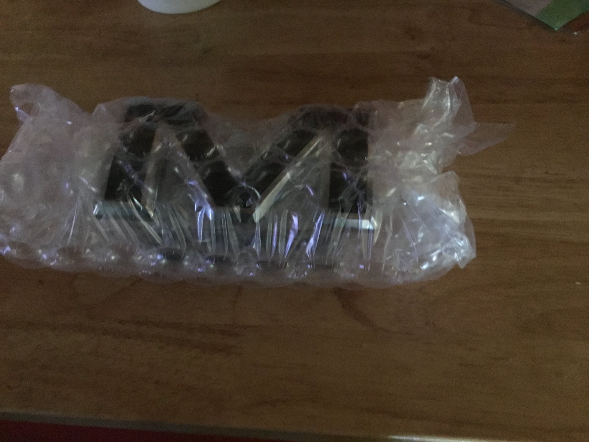

Just installed mine this afternoon. Super easy thanks to tips in this thread.  The black version comes with rear black (non-led) logo. I’m not going to install it. If anyone wants it, please message me.

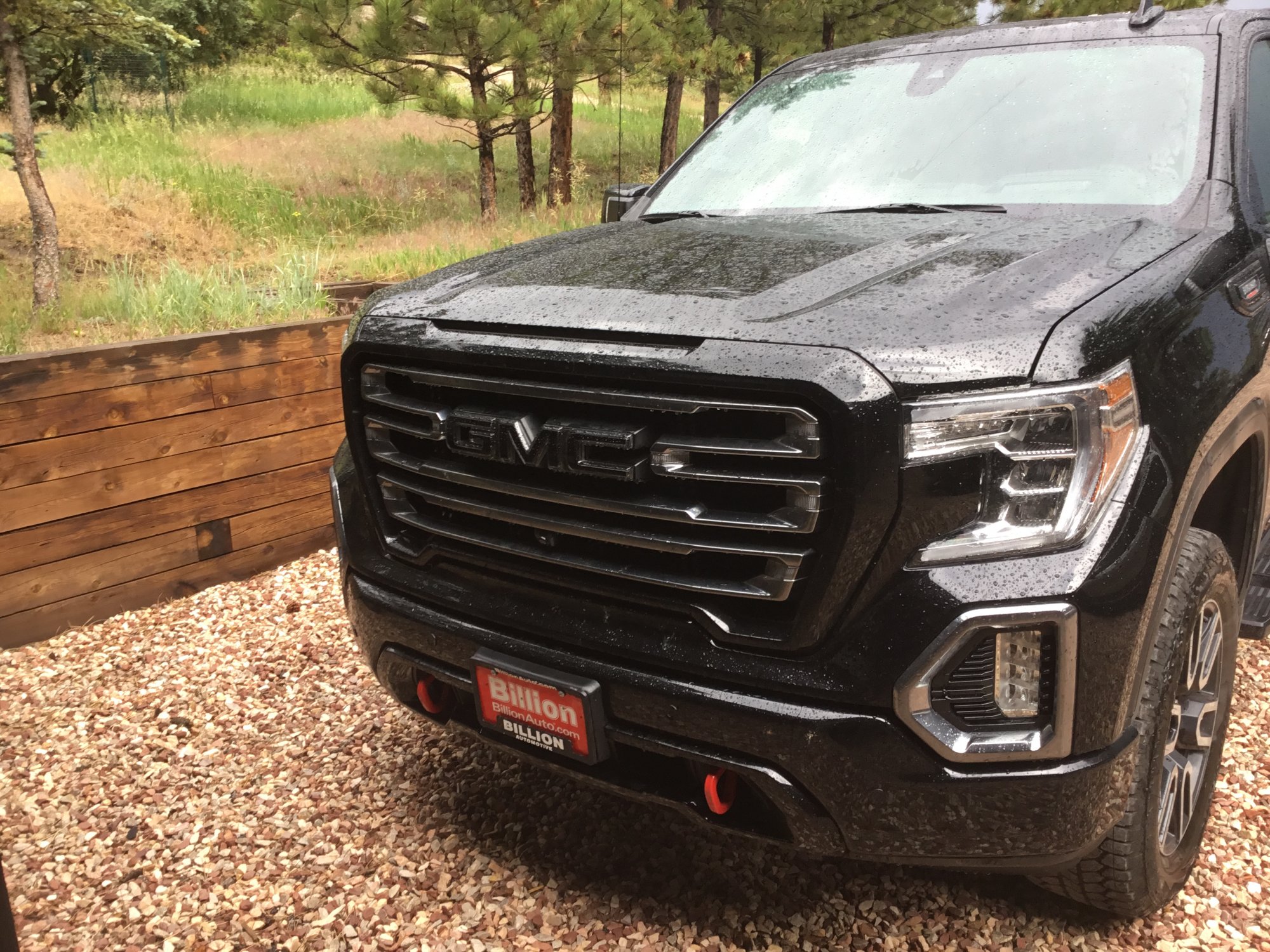

Went to my local dealer and they had them
in stock! Very fast clean Mod that looks awesome!
Does it look that bright in person? I always think other people's looks brighter than mine.
It’s decently bright but I feel like the camera makes it appear brighter!
