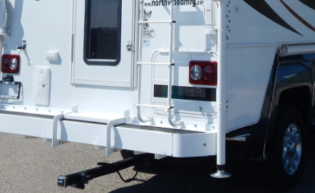

On 2/26/2020 at 4:10 PM, Morgan Swisher said:
How do you like that reese hitch extension? Does it hold up very well or in your opinion is the superhitch a better option? Trying to decide on which one for my 2020. Thanks
