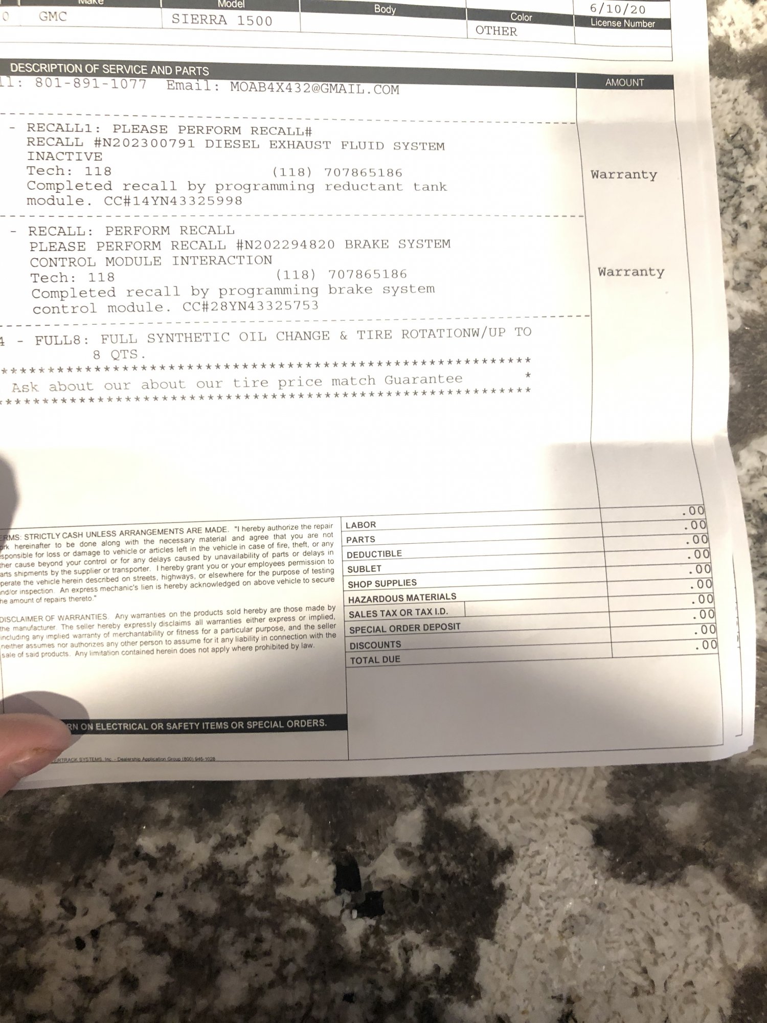

Is there a TSB # listed on your service ticket? I'm trying to figure out what DEF recall there is
Sent from my SM-N975U using Tapatalk
Hmm can't find any info on that TSB other than the title. "Diesel exhaust fluid system inactive" (not paying $15 to access it)
So if the system was not injecting any def previously that would be why your def consumption went up.
Here is their explanation from April 2020. Looks like they are using calibrations for future NOx guidelines.
"Under certain conditions, the ECM will increase or decrease the amount of DEF used based on learning or adaptive algorithms."8d075aa4c05509c379c880a2d1950208.jpg

So at 3,400 miles my 3.0L Duramax check engine light came on.  I scheduled an appointment with GMC to have it looked at.  Upon picking up the vehicle was told it was related to a recall.  After reading your post and looking at your service ticket I have the exact same Service Update Bulletin (N2023000791).   Since the update my DEF consumption has nearly doubled.
