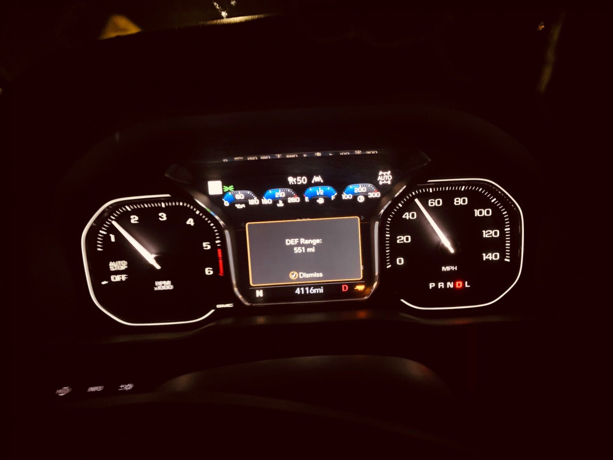

I have a 2020 Sierra 1500 AT4 with the 3.0 Duramax.   I just got back from a 2500 mile trip pulling my 27" RV about 6500 lbs.   I used 15 gallons of DEF.   This seems a lot!  the pictue below with miles at 4116 the DEF was Full.  At 4475 miles I was almost out.   I took my truck to my local GMC Dealership when I got back. They can't seem to find anything wrong with the engine.    Does anybody have similar issues?  Is this normal?   Thank You..

You used a full tank and a half in 2,500 miles???
How much fuel consumed?

I took mine in for excessive use of DEF. My post is on earlier on this thread for details. Chevy said they reprogramed to hopefully improve but gave me a written explanation telling me to expect high usage while towing. I was back at the dealer today (my truck lurches into gear upon restart after sitting at a light. Im told this is a 2 day fix after waiting almost 3 months for the part) and they asked if my DEF usage has improved under load. I can't answer because I have not had an occasion to tow anything more than a few miles. Apparently,, now there is a recall notice for excessive DEF usage with the 3.0 Duramax.
