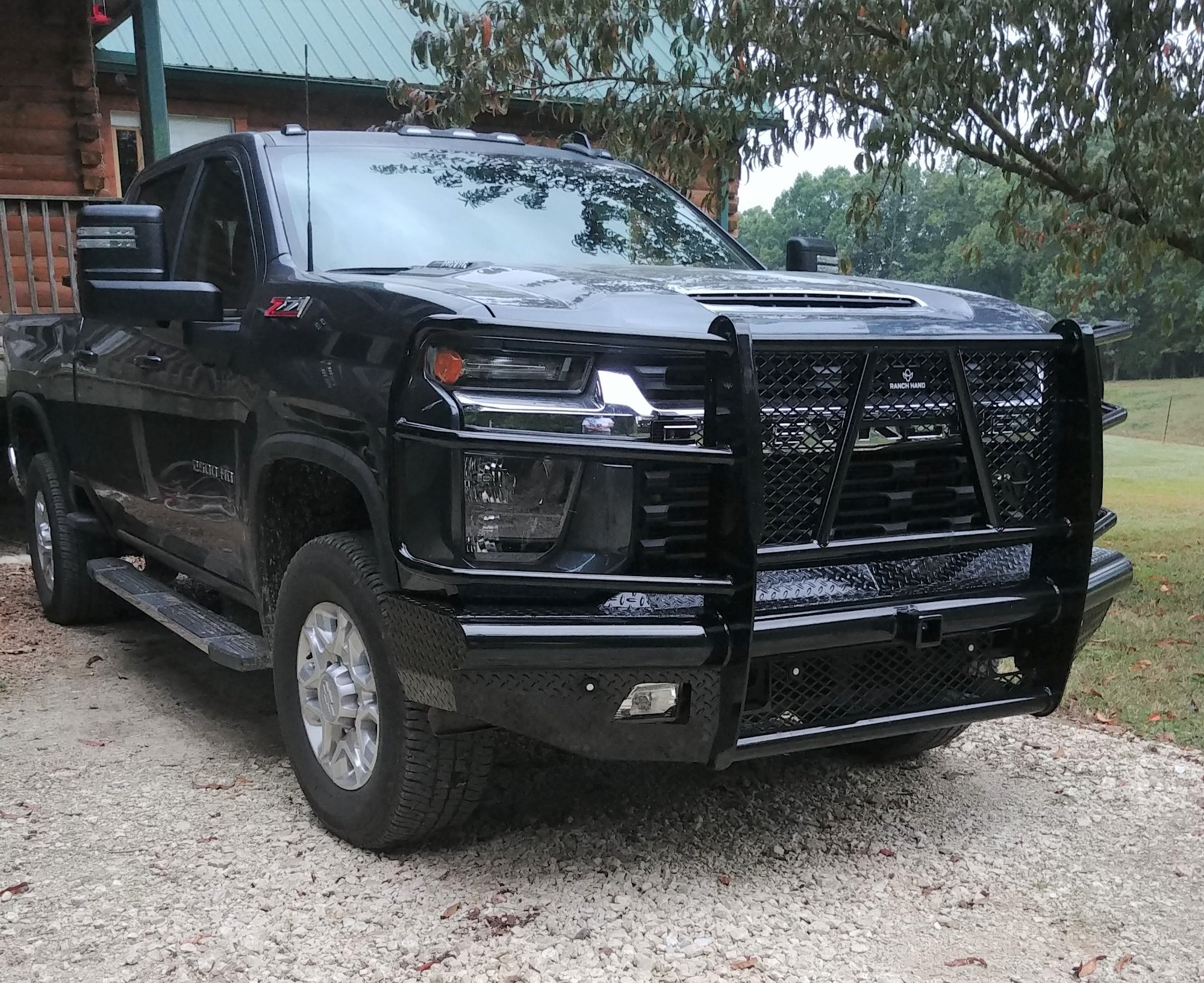

I picked up this 2020 2500 HD with the Z71 package and it's going to need tires in the next 5-10k miles... not sure if I'll have the funds saved up for the level and wheels before it needs tires so I'm wanting to know if it would be possible to put 35x12.5 tires on my stock wheels and not rub on stock suspension?
I just put Nitto Ridge Grappler 35x12.50x20s on my 2020 and needed to do a 2inch level on the front to avoid major rubbing.  I also put 20x9 +18 wheels on to match the stock size.  You could also go with 20x10s, but trimming would likely be required at that point.  I had no trimming required with the 35s on the 20x9 wheel.
