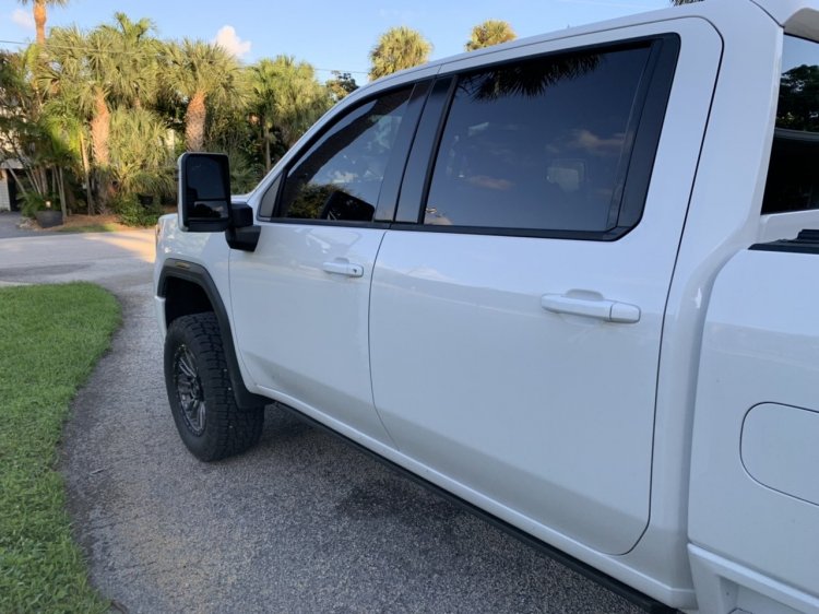

So far I have done 3M Paint protection. Ceramic Coated Paint. Tinted Windows and Marker Lights. Some chrome delete.  Lopro soft roll up tonneau cover. DPF back exhaust.
9"x 20" black iron wheels +18 offset with 295/65r20 nitto terra grappler G2s. Stock suspension with front torsion bars turned up 3 turns. No rub and rides excellent. Let me know what you guys think?
Next things on the list include more chrome delete and a banks derringer tuner.
