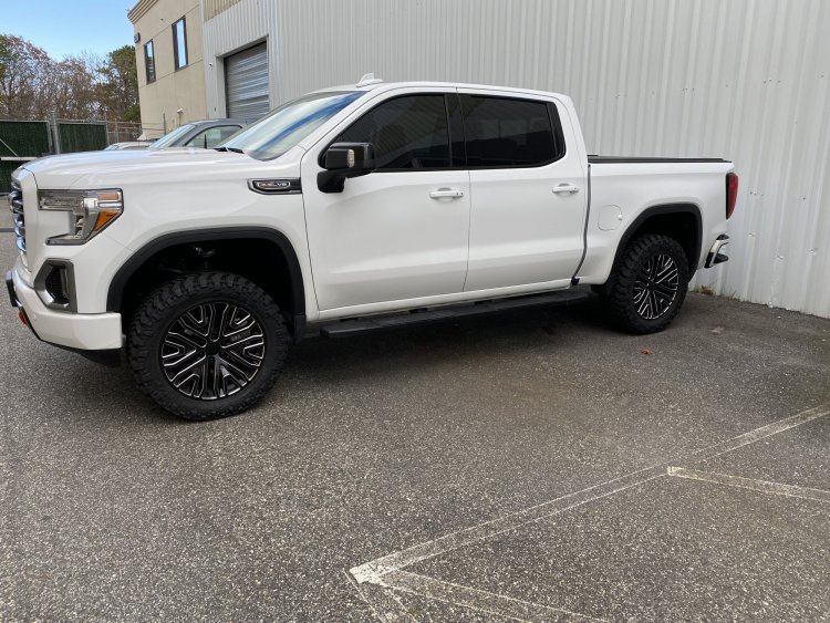

I do, but I have a 3" lift and I had a little rub on my mudflaps with stock wheels. I trimmed a very little bit on the plastic flap and have been running them for 5k+ miles with no issues
They are replica wheels the fit and finish are very nice. They are OE performance wheels.
